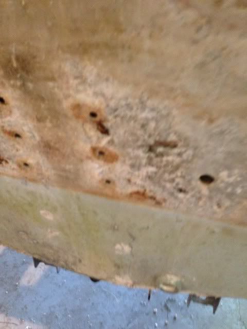

rotten rear deck
part of where water was coming in, this is where a rivet once was for the knee brace.

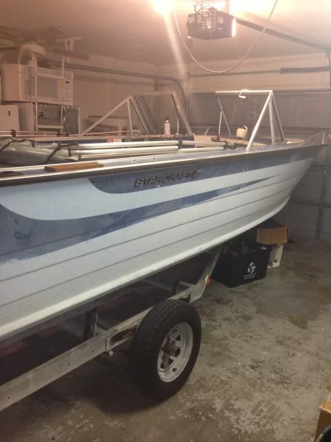

getting there
too long for garage

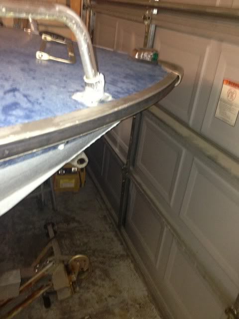

she's in
By the skin of her nose..

But how ya getting her out of the garage? :confused: :watermelon: It that a tilt trailer Kev?

And for now, I have a jack stand on a 4 wheel furniture dolly.
That will let me push her forward a bit and push her back in when the daily rains hit

Discovering quite a few issues as I peel back years of neglect on top of misguided liberal applications of household white silicone.
Knee brace was entirely pulled from the hull.
Every single rivet was busted.
The stern skin....well the piece of wood that was used between the Johnny and the transom did what they do best, trap water and accelerate the eventual corrosion of the aluminum.

Looks like a great place for about 1/4" thick chunk of AL sealed w/5200 to replace the water trapping wood cushion.
How are the knee brace rivets through the bottom of the hull? FUBARed too?

Fubar pretty much sums them up GA
Most snapped, a couple pulled out with the brace.
Going to have to spend some quality time behind the drill, on my back under her.
Oh and of course I have a split on the flange of the brace where it attaches to the transom.
No dammmm wonder she took on a few hundred gallons on her initial "lets see how bad it is" splash.
