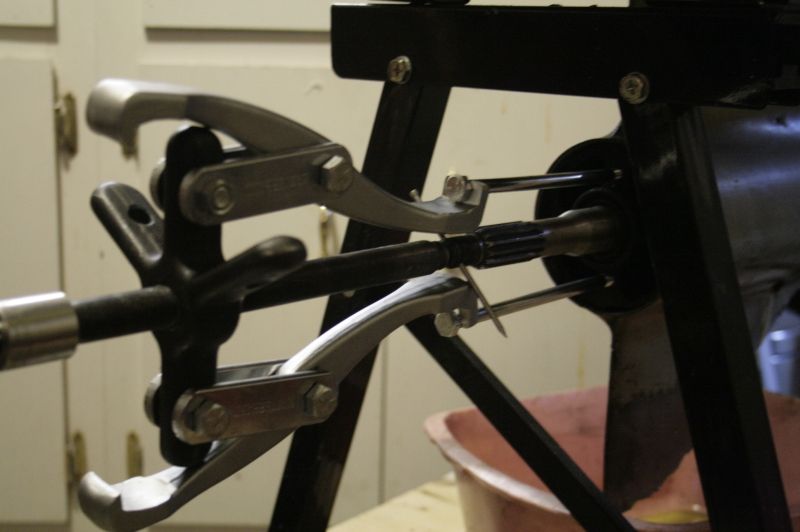

archcycle
Sep 21, 2009
647
Re: Drive shaft snapped (1990 140hp)
Sorry about that...ours have different threads...
You were actually correct it was 1/4 x 28. It turns out the rods were 20.
I rigged this up and failed:
It bent the crap out of the rods and i started to get concerned about the amount of lateral force on the prop shaft as the rods bent and the puller torqued sideways so i let this one go. For all this trouble and time i'm starting to lean towards just finding another one on ebay.. fishing season is on after all.

Did you use heat? And did you empty the gearcase lube? Mine bent some rods until I heated the crap out of the outer case!
boobie
Nov 5, 2009
20,826
If I read your picture right you're not supposed to be pulling on the retainer bolts as the retainer is held in by a snap ring. There are two holes in the prop shaft carrier which you should be pulling on. They are either 5/16" or 3/8 ". After you remove the carrier you can then remove the snap rings to get into the rest of the G/C.
