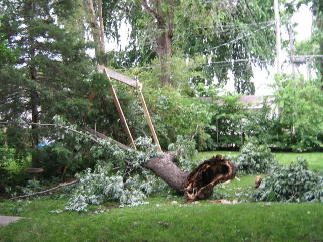

I made a frame to remove my engine using a large tree for one of the sides and a 4x4 for the other. Because the tree was not going anywhere I only had to brace the 4x4 front to back. I used an old piece of steel from warehouse racks for the beam, but a couple of 2x8s would probably work too.
You can see photos in post #5 of the thread in my signature.

you can see why i didn't go for a tree limb....
fbt's set up is what mine looked like in use too. come to think of it. i think fbt may have given me the idea... it works good..
FreeBeeTony
May 15, 2002
3,997
Re: Engine Removal
Yes, this worked well........I also used it to lift the SBC out of my current boat.....twice....:)
I just added some 2x4 supports between the legs and the top......
