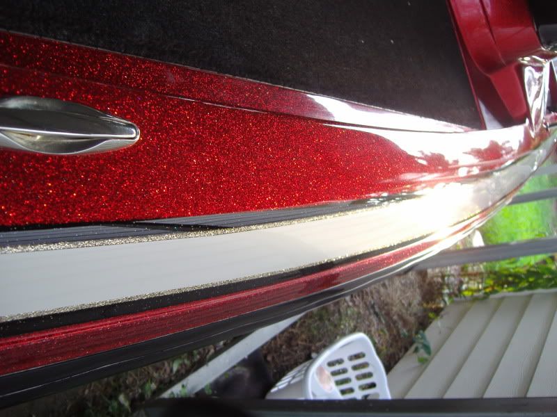

My boat was pretty heavily oxidized, and I finally bit the bullet and wet sanded it. It was worth the time, and I think the results speak for themselves.
This is the articule I used to do mine. Great breakdown of what needs to be done to wetsand a boat.
http://www.bbcboards.net/zerothread?id=311487
This is before and after. Ignore the overspray from the buffer :eek:

Re: Fiberglass Restorer or New Paint Job for a 1970s Fiberglass?
Thanks for the clarification.
Pretty boat by the way.
Thius gives me a good idea when I get the bass boat.
