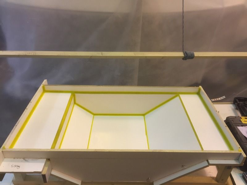

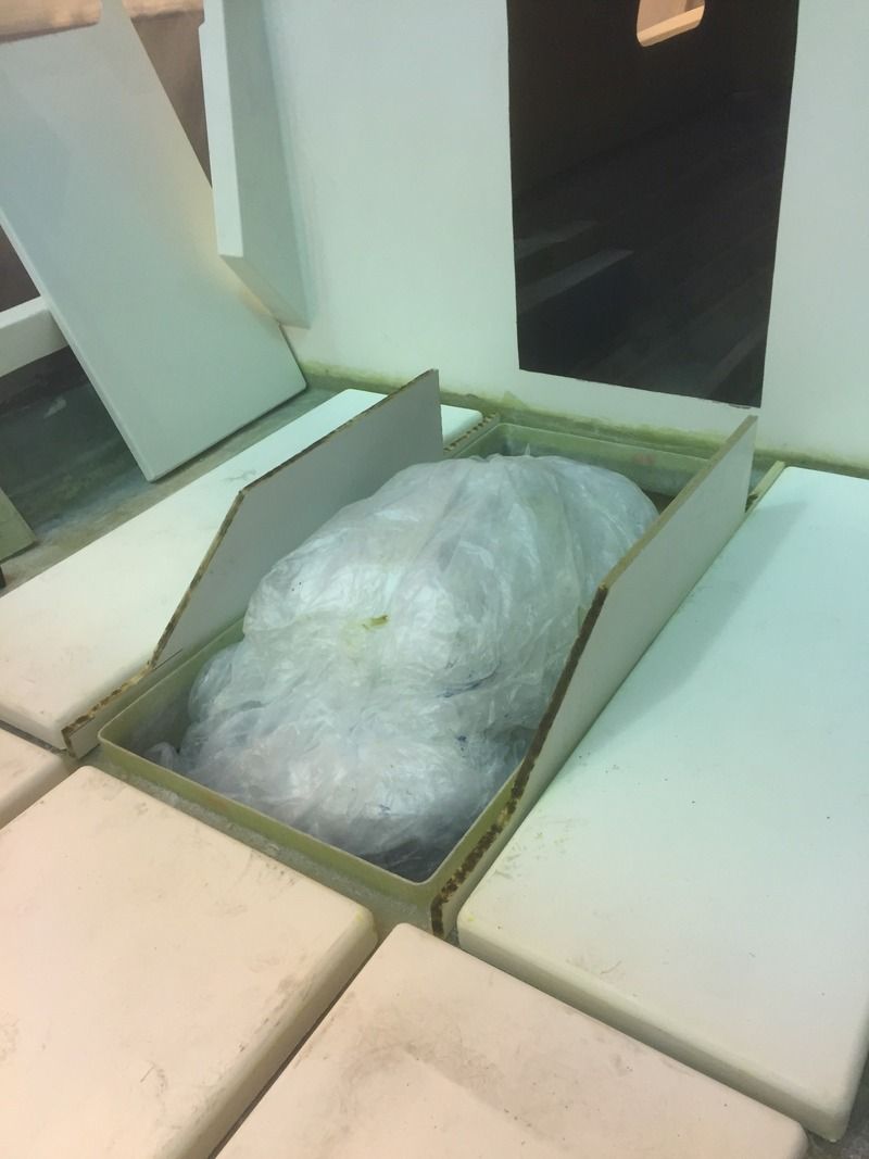

Now I'm fooling around with the engine cover.

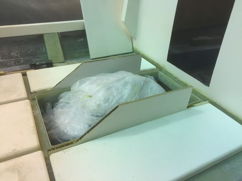

Chilly -20c today! But the sea is still fighting the ice somehow, hope it'll freeze proper so we'd get a chance to ski right outside of town.

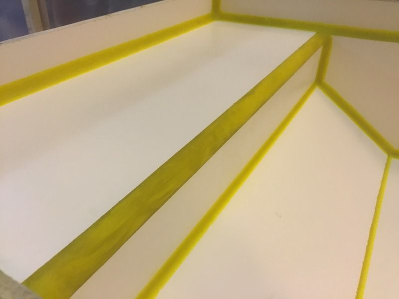

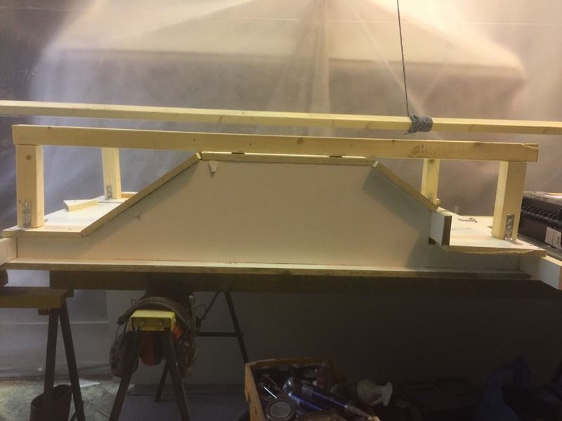

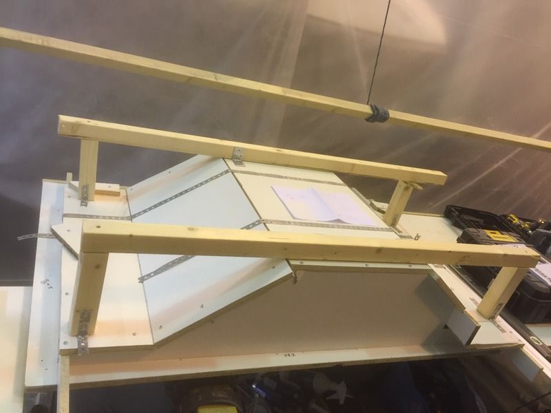

The mold for the engine cover became a bit of a bunker after all my reinforcing. It'll end up a bit boxy since the sides are straight, but I'm hoping some serious fillets will help with that. Now I'll need to get some help turning it over :)

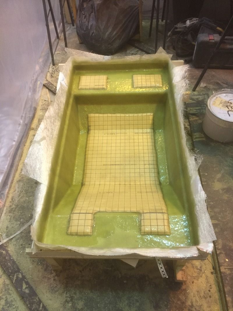

Now it's time for the first gelcoat layer, and tomorrow morning some marathon glassing.
Had to make some custom fillet tools to make the inverted fillets, but the results seem ok at least. Managed to make two extra pieces of melamine a bit slanted inside the boxy mold, so that the shape gets approx 5 inches thinner in the upper part. Hope it'll look ok!

Phew. I'll glass the rest tomorrow. I wonder if the side walls should get some divinycell as well?

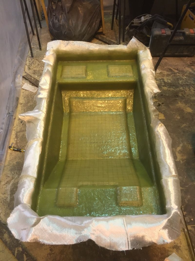

Blargh. Broke my speed record glassing five of those pieces in less than four hours wet on wet(including cutting and fitting of the pieces). The method gets things done but it's messy and hard on the nerves.
Started using a new biaxial mat that's a bit thinner than the last one, and honestly speaking it sucks big time at least for wet on wet layups. It doesn't maintain shape when wet and it's almost impossible to fit nicely on a sticky surface. Will order some new mat as soon as I can.

Found out why, the old one I had was triaxial 0, 45, 45, that's what I'll have to get
And gm, it's not much to see. The trickiest part is prefitting the pieces(especially wet on wet). I wouldn't have done it like this if I wouldn't have been in a hurry, glassing five layers in one go could lead to warping. I had five layers underneath which should be stable enough to keep it in shape, and I used a very mild mix (1.5%) to minimize heat build up, and the shop is quite cold even (12-14c).
