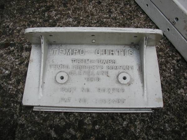

Get a free Photobucket account and you can post nice big pics like this:
They automatically resize when you upload them to photobucket so you don't have to worry about what size they are.
