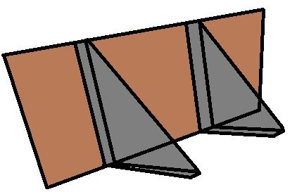

I'd build a "full cover" 1 1/2" thick plywood transom and full aluminum angle braces like this...
