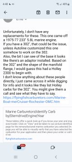

This is a reply from mikes carburetor wich from what I understand this carb doesn't belong. Any input on what he says

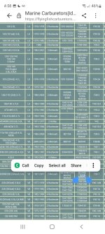

Also shows a holley 2 barrel

And you can buy a Holley Marine 2 bbl carb brand new; better than remanufactured which is what you’ll get from Flying Fish Carbs. Yeah new costs more….
0-80320-1 I believe is the # of the Holley 2 bbl calibrated for the 302 cu in Ford.

All 188s came only with Holley carburetors. Someone may have taken the adapter from a 233 which only came with Rodchesters atop the Holley pattern adapter that mounted the Rodchester.
53,056
If you are buying a carb, I would go 4 barrel over 2 barrel myself
However there is not much to a Holley 2300. It is literally half a Holley 4150.

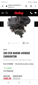

Correct?
