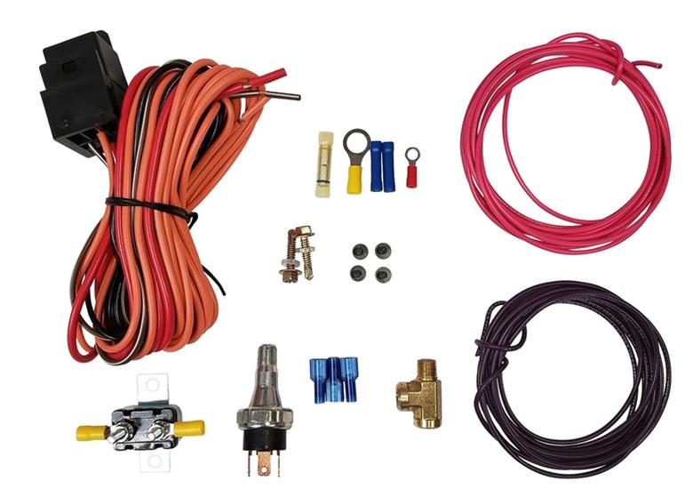

i also purchased this fuel pump relay kit that comes with everything needed. relay, wiring harness, oil pressure safety switch, starter wiring, brass TEE fitting for oil pressure sending unit.
should be relatively painless to install

That isn't a marine fuel pump. It's a fire hazard if installed in a boat.
thanks, what do you recommend then? chevy 350 5.7 just like the OP has, need one that is 5-7 psi. when I search google, amazon, west marine... i either get listings of mechanical fuel pump replacements or in tank marine electric fuel pumps.

try googling carter marine fuel pump thats what lead me to summit.... https://www.summitracing.com/parts/crt-p4389 . None of the electric fuel pumps have the overflow tube as they dont have a diagraphm to rupture like a mechanical pump that requires somewhere to fuel safetly go.
As nola pointed out the edlebrock one is not marine rated which means from a gas leakage and spark suppression/electrical standpoint they are not designed or rated to be in boats
