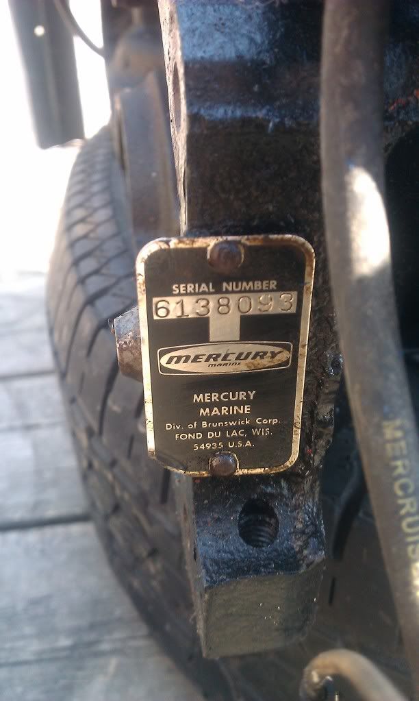

Ok scott. Will do. Im picking the motors up Tuesday ..I see what I got. N post my progess. So my out drive its more than likley its alpha drive right. It's seems to only weigh around eighty pounds. It's has sticker on it saying 898. I have paper work on it and serial numbers so I guess I could go from that right.

Yep sounds like you have an 898 engine in front of an R or MR drive....pretty much exactly like mine.....
The serial number on the side of the drive will tell you if it's an R or MR

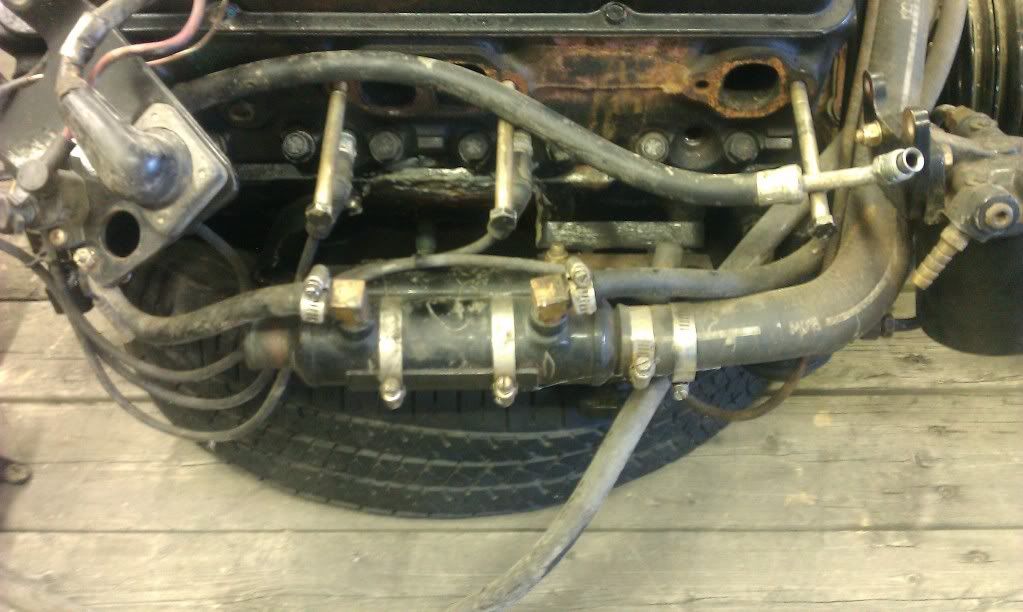

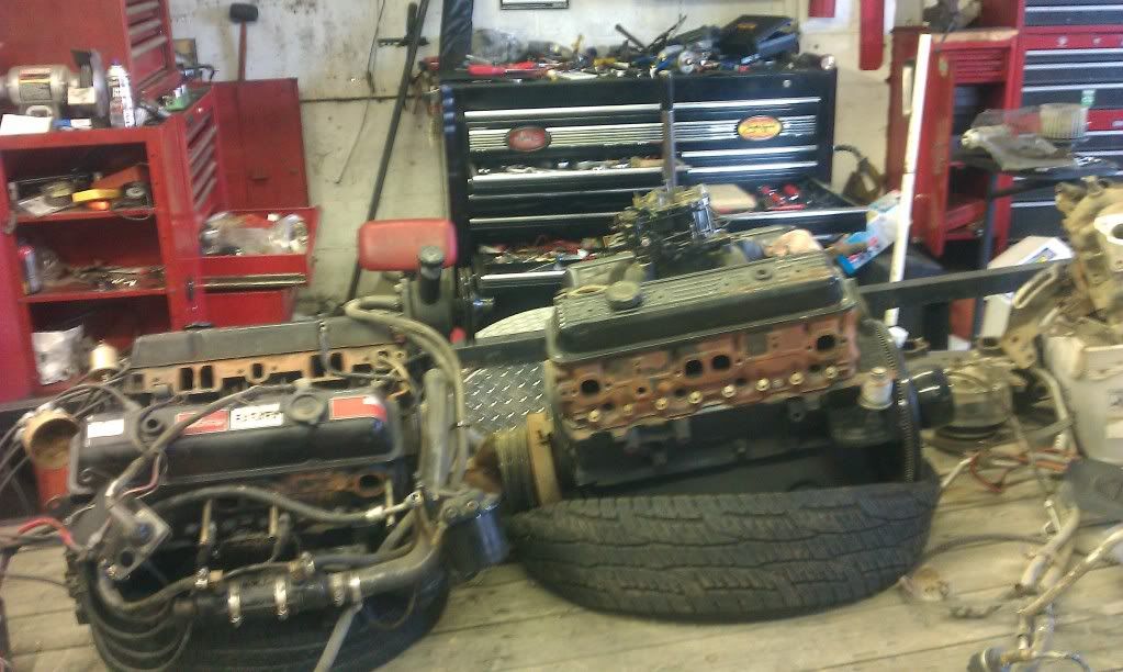

got my motors finally ...the 898 had two cracks in the block...i have a 350 5.7 came out of 1989 chevy truck with 20,000 miles..on it.
i ordered all my gaskets for the exhaust...the 898 has fresh water cooling system on it ...dumb question..but what is it for and what does it do..im going to upload alot of pics...so any advice on anything plzzz let me know ..or any suggestions..will be helpful...
