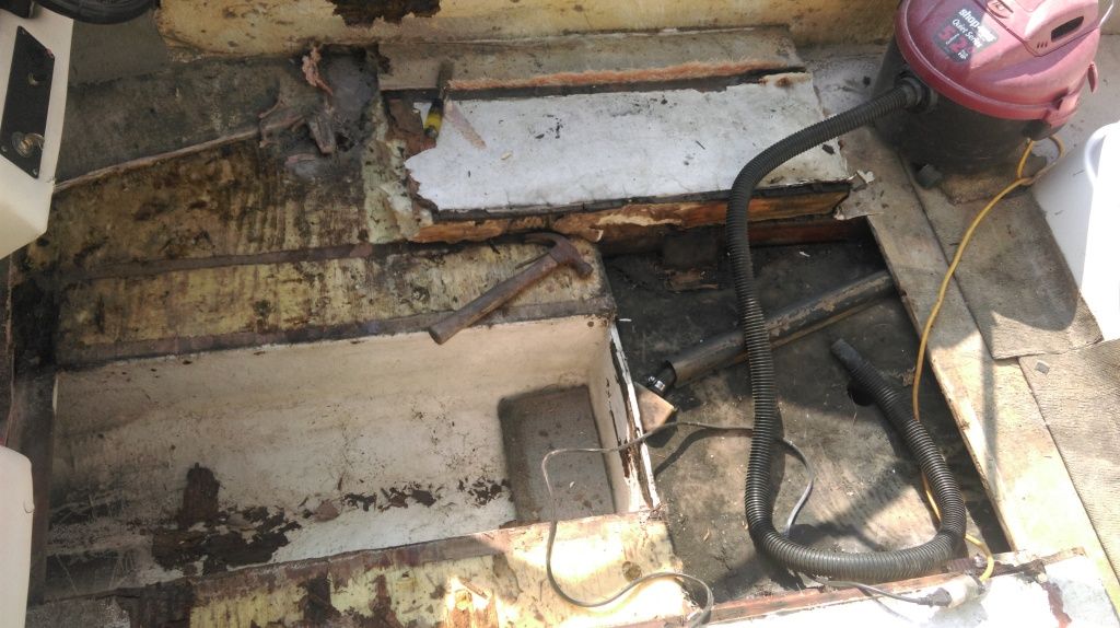

Ok, ugghh all day of cutting grinding and scraping...floor was rotten ONLY in the center where the seat based are. The back and the front floor look like they've been replaced recently. They left the hardest part for me apparently lol
This is more than I wanted to do right in middle of season but once I got started I couldn't stop lo
There is foam between stringers and it's not wet belive it or not. And the stringers are excellent shape.
So looks like I'll be putting new floor in the center section before replacing seats.
My questions now are about the edge of floor where it goes at a 45? angle, how do I repair that part?
I'd like to not put in New carpet, but rather put a non skid floor material. Suggestions on this would be great.
I can use all the help I can get guys! Thanks

Um, Luke, your pix dont seem to agree w/ the spot under the seat being the only problem area.
This looks like an area thats higher then the surrounding deck:
and the foams appear to be different colors:
off hand, I suspect the previous owner did some work to this boat and came up w/ the pedestal that created this step up area between the seat base and the side of the hull:
But let some other fellas take a look, maybe they'll have a different take. What boat make/model/year?

Thanks jb, to start, yes I found that one spot you see in pic that's above deck level. It is the side storage area. The rotten seat base extended it up to the side storage a little bit. I'm trying to figure that out also.
The foam appears different color on the left is where the deck was on it, so it has kind of a "skin" on top. The lighter colored part is the foam from under seat base. I was starting to tear it out where it stuck above seat level.
And no doubt someone did some deck work before I got it. But the seat bases appear factory. It looks like they avoided this section because it was the hardest.

Did you do any sort of core sample to see if the foam is wet at the bottom? The stuff on top can be dry as a bone, while the foam below is saturated. I hope yours is dry, but better to check.
Lukelona
Mar 9, 2013
449
Yes I dug into it in a couple spots. Only spot was wet was on the edge by the seat base. Which that foam was removed anyway. The rest seems solid.

Do you guys see the big open hole where the gas tank is....when I put my new deck sod down how can I brace and support that spot?
I think it's too big for just the 3/8 or 1/2" floor to be strong. Seems like it may flex. There is about 3" between gas tank and deck level.
Also the spot at edge of hull where it angles up a little...I'll be cutting it out when I finish removing seat base. How can I rebuild that angle?
