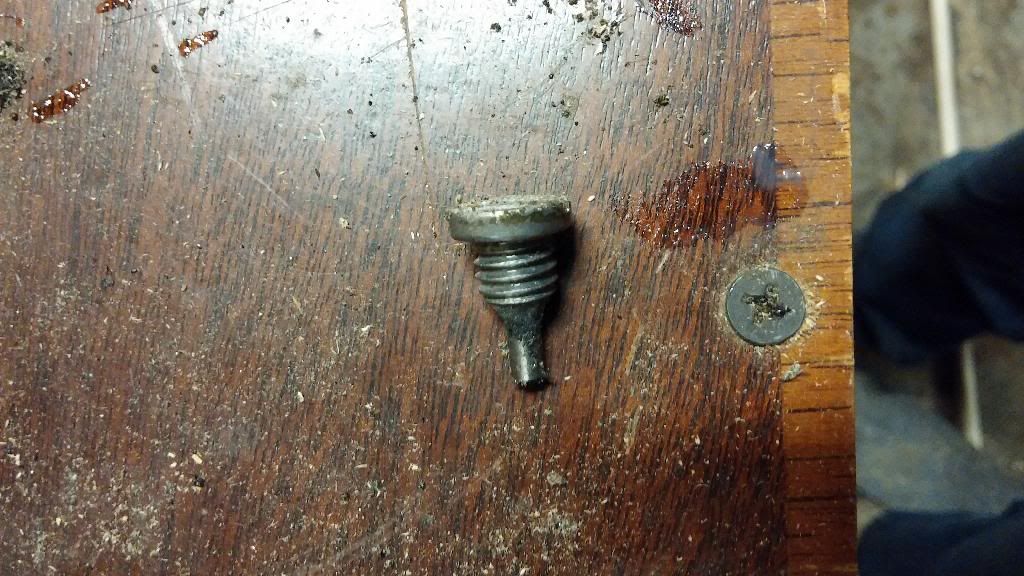

Cut a new bow support board today, also pulled the lower unit, and started the water pump change its a good thing I decided to it was on it last legs, the gear oil didn't look like it had been changed in forever and more bad news it had water intrusion as well, the reason again previous owner. Whoever changed the gear oil last neglected to put a seal on the filler plug.

No seal.

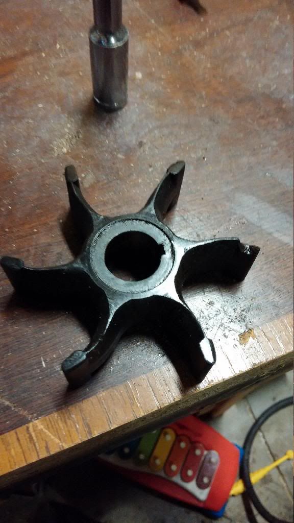

Water pump
You can't really see it in the pic but all of the blades of the water pump were checking and cracking looking like a dry rotted tire. Not to mention all of the tears in it as well.
