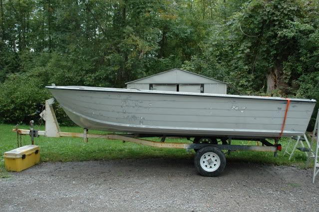

hi guys got this starcraft super sport the other day
andythomas
Aug 29, 2011
38
splashwell
splashwell
any ever make a splash well or know of a place that sells them. have a 16 foot starcraft ss and its missing

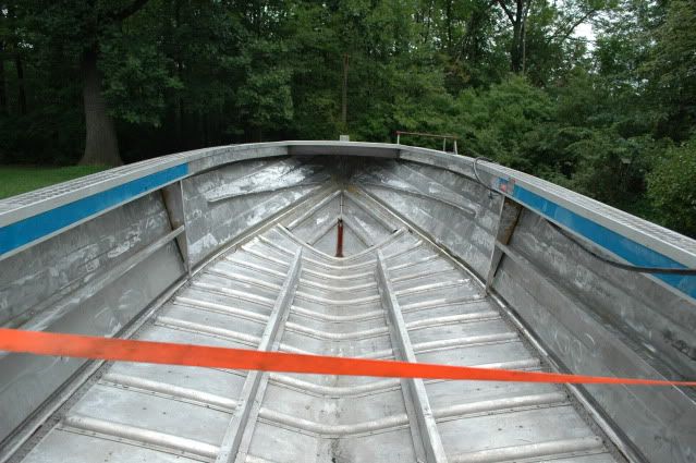

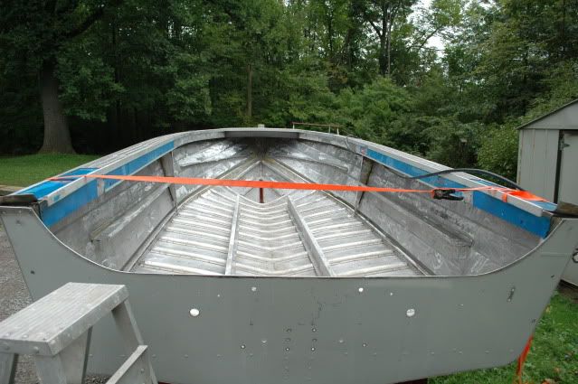

well had to reformat the camera :( , but i was able to pop the transom out in between lightening storms yesterday, after reading everyone elses post about removing transoms i think it cam out rather easily(knock on wood) took 5 minutes to get it out.
today we sprayed the inside out with PURPLE POWER soap and power washed the inside out. tommarow it is sanding the inside to get all the old glue and caulking out so i can seal it this week. where o where is that epoxy!

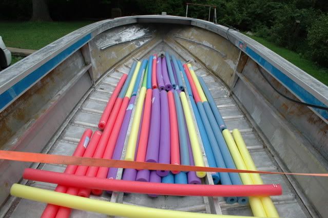

went on a noodle run today, had to really look for them since it is the end of the season. ended up with 45 noodles, 20 monster size and 25 normal size.
i might try and find some more.
i was also able to get some sanding done on the inside, half of the inside of the boat done.(dang weather)
the epoxy came today so time to start on the transom, and then finish sanding the inside to seal the seams. then the outside will be the next on the list, any hints on sanding this thing? do i need to remove all the paint or just rough her up?

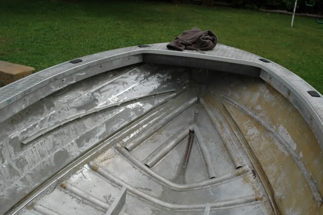

wish I would have seen this sooner... maybe it will still be of some use for half the hull -- I just found out from one of the other members here that you can remove that carpet glue with lacquer thinner... unfortunately I found out after I had just finished wire brushing the entire inside of my hull. I had tried lacquer thinner before I broke out the wire brush, but apparently you need to let it soak not just scrub it - take a paper towel, soak it, and slap it over a section of the hull - let it sit for 15-20 minutes (you might have to re-wet the towel). the glue should just wipe right off after that. It did in the couple tiny spots i had left on my hull where I tested this out. (credit to fishrdan for the tip)
what kind of shape is the paint in? is it flaking or cracked? can you scratch it off easily? if so, I would guess remove it completely. I would also check it over carefully for any spots where the paint is flaking to see of the metal is pitted - I am seeing small spots of that around snaps, cleats, railings, etc.

the outside pain is in nice shape, a few small spots that are scratched up a little.

well tried the laquer thinner deal and it softened the glue a little but i still needed to sand it off.
started sanding the outside with 150 grit
