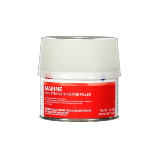

I'd use a dremel to clean it all out and feather the edges of the gelcoat. Wash down with acetone and Then I'd use some of this..
mediawebserver
to fill the area, leaving it a little shallow. I'd then mix up some thickened Gelcoat paste to bring it up past flush. Then sand down to flush sanding all the way to 1500 grit then buff and polish. You'll never know it was there.
