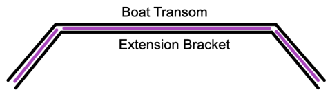

When I made the transom mating surfaces, I used corrugated cardboard as a 'padding' to mimic the thickness of fiberglass.
Of course, if the fiberglass is thicker than the cardboard I used, it would explain the fit problem.
The fiberglass was 2 layers, so about 0.09" each side . . . Probably more than I had allowed for.
The angle is 120˚ and the gap is 5/8" as mentioned. I can probably figure out the needed dimension reduction in order to fit.

Something isn't right . . . My geometry calc's are indicating that the extension bracket would have to be off by about 3/4" on the width to be stopping 5/8" short of the boat's transom. (possible, not plausible . . . :unsure: )
I have a hunch that it may be a matter of height, not width. So, I'm going to try lowering the 4x4 that I have running along the keel to see if that makes a difference.
