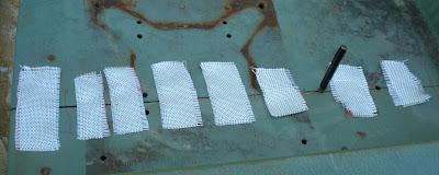

The repairs from last night are rock solid. Tonight I made templates for glassing the outside channels and the transom. I also laid out and marked the cloth for the outside channels, the transom and the deck. I still have a LOT of 10oz cloth left.
Here's one of the templates I made. There's one for each side. I'll need to get in the boat to do the center channel so I'd like to wait until the outside ones are done because the hull will be stronger.

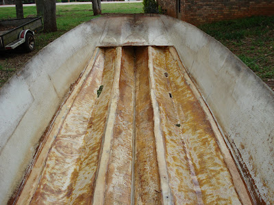

As requested, here's a shot of the repair as viewed from outside. It's difficult to compose a shot showing how the shape of the hull was maintained but this is pretty close. I'll get some more shots when the hull is flipped for finish work.

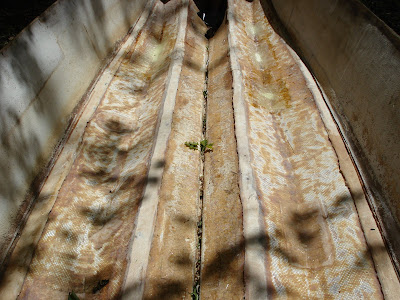

Today I suited up for some grinding first off, then got the cloth glassed in on the port side channel. My back was pretty shot out from working slumped over the side so I decided to save the other side for tomorrow.

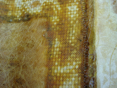

It becomes pretty transparent when wetted out but if you look closely you can see the texture of the cloth.
The new cloth is applied over the original roving. The mat patch at the left of the photo is also part of the original construction.

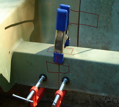

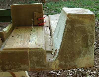

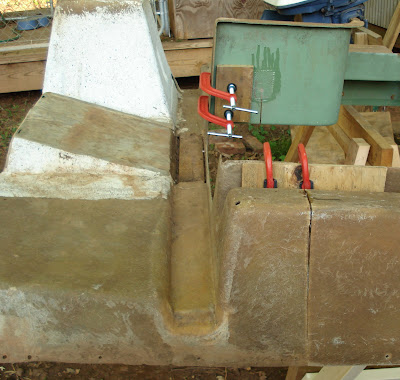

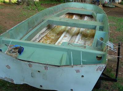

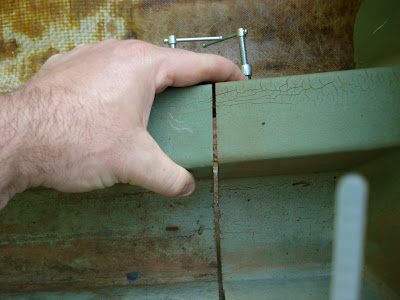

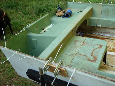

I also began the work to reunite the cap where I cut it. I used some wire ties to temporarily reinstall the cap. Then I clamped the two pieces back in their original place. The rivet holes serve as a guide.
The rest of todays pics can be seen here.

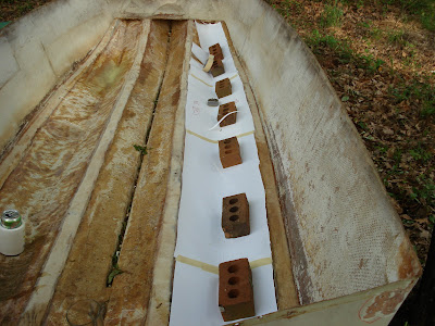

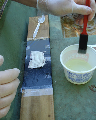

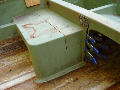

Started work again after breakfast. I finished fine tuning the alignment of the pieces clamped together. Then marked off a few key areas, scuffed, and cleaned with acetone. 8 small tabs of 10oz cloth were cut and glued up on the areas that were marked. The idea is to have as little as possible to grind off later but still be strong enough to remove in one piece. At the very least I'll be able to take the clamps off this afternoon and add more strips if it needs it.
Strips of clear tape were added in key areas to prevent gluing the cap to the hull.

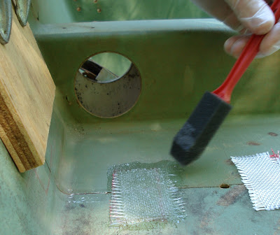

I made a little work surface using a 1x4 and some plastic. Again, this to avoid making a mess that I'll end up grinding off later.
Gluing the piece down. It's hard to beat these little foam brushes.
I have a lot more pics showing the process in greater detail. Those pics start here.

Reunited...
More tomorrow. :)

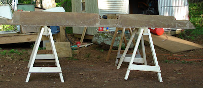

BTW, I needed another pair of saw horses so I built some new ones just like my old ones. It's a neat design... All pieces except the braces are 36". The legs are mitered and beveled 15 degrees. The braces are mitered at 15 degrees (no bevel). You can screw or nail them together. They're also stackable. I found the design posted online by a contractor years ago when I got my miter saw. You'll need 3 8' 2x4's per saw horse. If you store them outdoors a little tar on the feet will make them last forever.

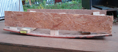

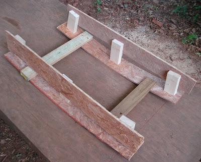

I decided to take a break from the glass work and build this bending jig. This will be used to bend the fore section of the deck. I set the curve in the boat so it's right.

Yes, the zip ties worked pretty well. I got a bag of 1000 at Big Lots for $12. That's hard to beat. Poking a center punch through both holes helps to align it as you cinch down a zip tie in the neighboring hole.
