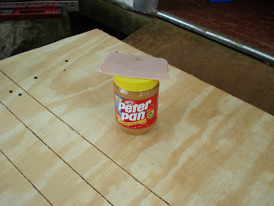

Thanks. Nothing really photo worthy tonight either. The last bit of glass in the hull is done along with a fillet of super duper glass reinforced peanut butter along the bottom of the transom.

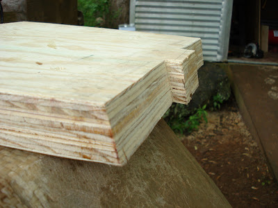

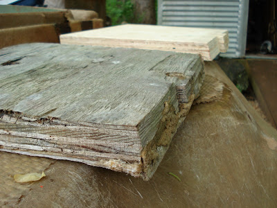

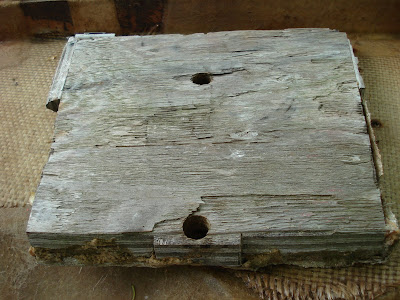

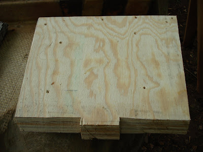

I went ahead and finished building this piece using the wood I glued up yesterday. I only have a Skil-Saw, jig saw, and hand saw. This was really tough to cut and took about 3.5 hours to do. I finally said to hell with the power tools and made the last cut with a hand saw. I think it turned out pretty well.
This piece has to "dovetail" with the cap so it's very critical that I glass it in properly. I'll have to put the cap back on to get the alignment before I glass it in. So the deck waits until this step is done.
Here's a few old and new shots. I used the old one to take measurements from. Using a sliding t bevel, I was able to to transfer all the angles and bevels. This would have been a lot easier (and faster) on a table saw or even a band saw, but sometimes you just have to work with what you have.
I'll try to get a seal coat on it later today so that's all for now.

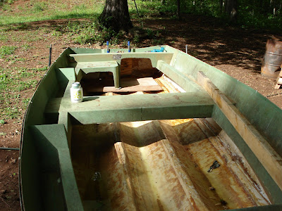

The weather finally cleared so I got a little done.
All clamps are off. Back in one piece and solid.
Lining things up and double checking the fit of various parts.
