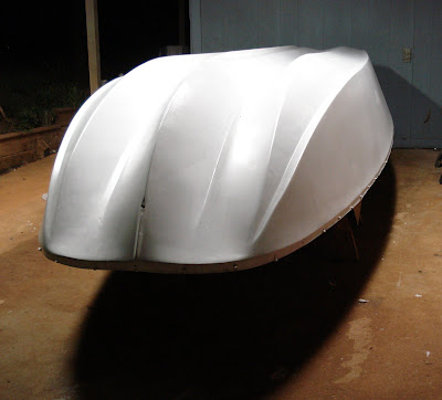

The first coat of primer is on.
1qt. of Interlux Epoxy Primecote thinned 20% 2333N.
Hull was washed and dried. Then cleaned with 202 solvent wash followed by a water rinse. It was dried thoroughly with paper towels, then dusted with a tack cloth. I did all that after I mixed the primer so it could sit for about 30 mins.
This was rolled with a foam roller and tipped with a cheap 3" paintbrush. I'm saving my good badger hair brush for the paint.
Next is to fill a few pin holes and other spots I missed, give it a good scuff sanding and give her another coat of primer. I need to build up the surface some more so I'll have something to work down to. I have enough primer for 4 coats. I'm hoping 3 will be the most I'll need.
