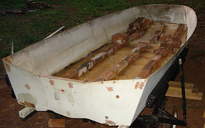

The deck is glued on with PL Premium like was discussed earlier. I used bricks to clamp it down.

Deck is in. Foam is in. Bricks are safely out. Deck is rock solid and secure. I had exactly enough foam to do the job.

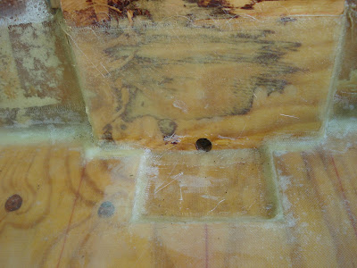

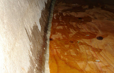

Here's tonight's pics. It was starting to get dark and I was really busting you know what to get this part done. It's going to rain tomorrow and I wanted everything sealed.
Here's the bilge all ready for glass.
Deck edges filled with peanut butter.
** Cut your deck more accurately and you won't have to use so much pb like I did. I didn't think too much about it when cutting. I made sure it had a solid gluing surface under all edges, but knew I could fill the rest. If I had to do this over I would have cut more accurately. I'm wasting epoxy and time. Structurally, it's fine. Just wasteful. Learn from my mistake.:redface:

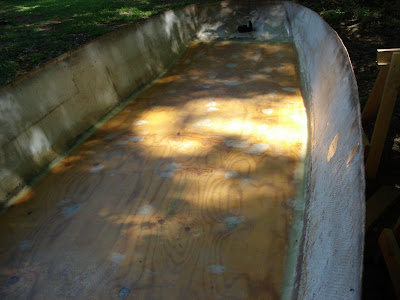

I got the deck glassed in on Sunday. I used mat with cloth on top. It took 5 hours to get it done and about a gallon of epoxy. I ended up with a few pancake sized bubbles that I'll have to cut out and fix. I'm not sure what caused them as they were not there when I cleaned up all my stuff and went in for a nap. Maybe because the sun came out. No big deal, just a little more work to fix. They'll be under the casting deck out of site, but I will still fix them.
Because the class transparent when it's wetted out, it looks like I haven't done anything for the past month. I can take some pics today but it'll probably be hard to tell the difference from before it was glassed in.

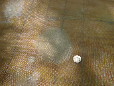

A couple of pics...
Deck is glassed in. Like I said, it's hard to tell. Most of the light colored spots are where I filled the holes for the foam pours. There are a few bubbles like maybe 3 or 4 that need fixing.
Here's on of those bubbles I mentioned. I'll cut it out and fix it. No worries. I have a few like this.
This will need just a little sanding before priming, but it looks a lot better in person than in this pic.
Bob_VT
May 19, 2001
26,084
Re: i386 Boat Restoration. (Crosby Sled)
What is that quarter for??? Ballast????
Looking good.
Looking good.
Nah, I thought I'd repair those bubbles with quarters. It's cheaper than epoxy.;)

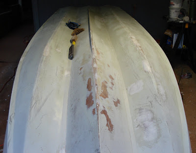

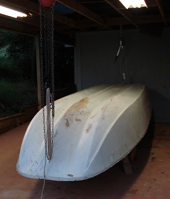

With a chain hoist connected through an eye bolt at the bow and come-along connected through the drain hole at the stern, I was able to flip it by myself. The chain hoist is really nice and much safer IMO. I borrowed them both.
Here she is flipped over and on saw horses in the carport.

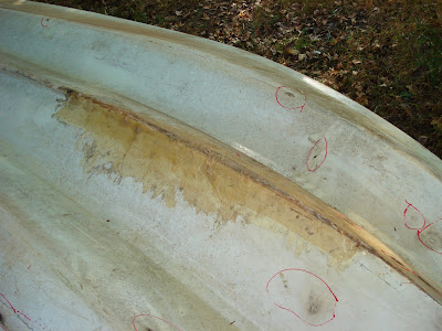

The old repair on the bow. Really thick and not very attractive.
Repair has been removed and some filling started.

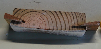

Behold, the i386 git-er-done narrow sanding block. This is the beta version.;)
