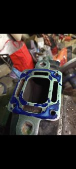

Thanks. Now motor is ready. I bought new riser, manifold were good so i will just machine the surface to make them perfectelly flat and remove the damage and than next week when ready i will switch on properly.
