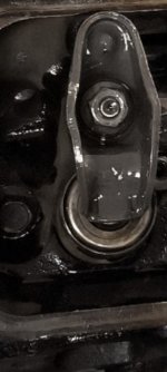

when you said: All the rocker nuts should go down the same amount; you meen 0 lash + 3/ or 27 nm?
In post 6 the pic shows some of the rocker nuts are not at about same position a the others, this is why I mentioned it
If not all had been torqued to 27nm then that also would be the reason
I'm wondering if some of the lifters are hanging up inside or on outside in the bores.
I wonder if you have a mix bag of parts?
How long are the push rods?
No now all lifter are out in oil tank. In the video i'm workin only on one lifter.
In the picture same, it was before to start to tight all i will make one picture after tight all at 27 nm but when i did the nuts look like same

As we all know something is wrong. The adjustable rocker will have self locking rocker nuts and you will not be able to tighten them with your fingers.
I bought this motor used and those are the bolt found inside. Do you think they are wrong? They are for sure not self locking . They have the not loosening part on botton (like washer) similar to the one in the picture
Is not right?

Alldodge good point on the self locking nuts. All of those should be replaced for the adjustment to hold.
:( didnt find any just 12 of this bolt found. But this is the only place where they could go

Online i can see this not like mine 😱😭

Yes that is a self locking type
Check the length of the push rods

with the old style adjustable you have to do the zero lash and either 3/4ths or 1 turn depending on whose spec you are using.

I will try to ask also old owner if this was the bolt that was on. But for sure if this were the bolt 0 lash +3/4 will not be safe at all

If the way I am saying to adjust them does not work, then the only conclusion that I can come to here is that you have either the wrong pushrods, or wrong hydraulic valve lifters for the engine and cylinder heads that you have. That's the adjustable valve train, it should be as I'm saying not torque to 27 and done.

This is right from my OMC shop manual and remember it’s a GM engine whether it’s Merc OMC or Volvo. For your adjustable valve train this is how it’s done and if it doesn’t seem right either the pushrods or lifters are wrong for the engine or something’s wrong with the lifters…and DON’T forget those nuts you have a wrong for the engine you need self locking rocker arm retaining nuts.
I did it exactly this way 8 years ago it’s still running fine.
