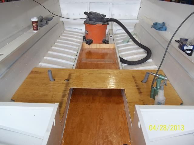

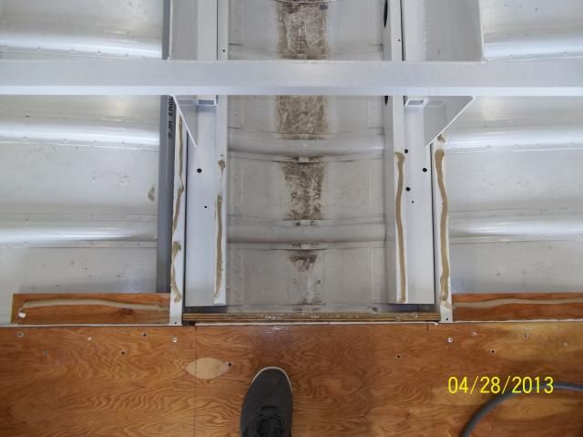

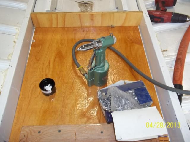

Progress update. Today was KILLER!!! Looks like some thing got done, gonna throw a bunch of pics up, most of you following this have done all this before but I am leaving a "How I did it"
Center foam cavity bottom piece

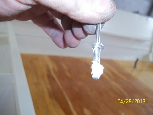

Rivet it in, lube rivets with caulk and install
Clean up the extra caulk from rivets

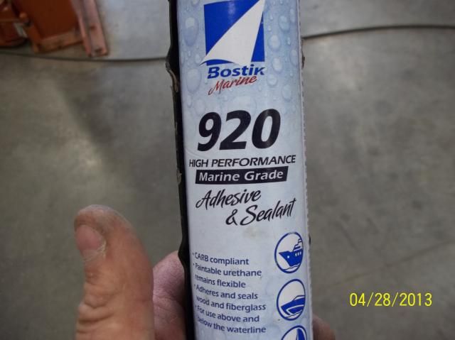

Marine grade caulk i am using, we found this at work for a pool application we had going, substantially less $ than 5200 with same specs, like 3$ a tube in bulk

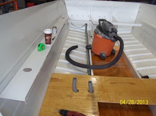

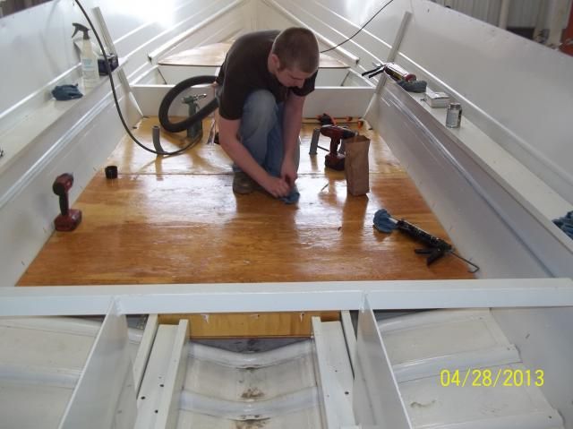

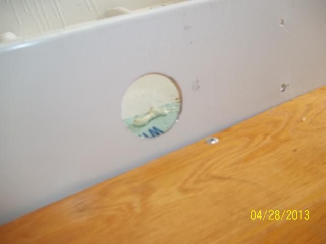

I drill a couple holes
Looking sweet, battery box to box conduit run
Bat box to motor run
Vacuum is in play for every hole drilled, when I demo'd the boat it seemed like every bit of assembly crap was still in it from Starcraft, extra nuts and bolts, tails from rivets, wood and metal chips from drilling, etc. trying to be cleaner than that!

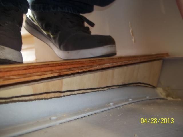

Prep for the next piece, I am using wood cleats instead of the original aluminum strips so it will be a mixture of riveting and screws.
One long cleat down the middle in the traffic area, stiffening up my slightly under 1/2" decking, PL premium glue

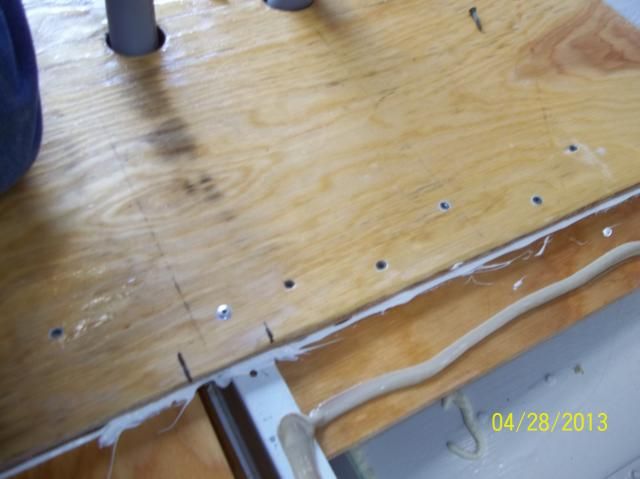

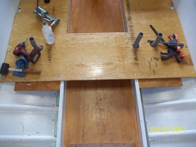

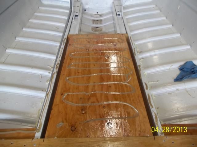

also putting a bead of caulk in between pieces
Next piece installed
one to go, same procedure with cleats glue and caulk
Left a nice gap at the back for drainage and access to lower transom for trim tab install or whatever.

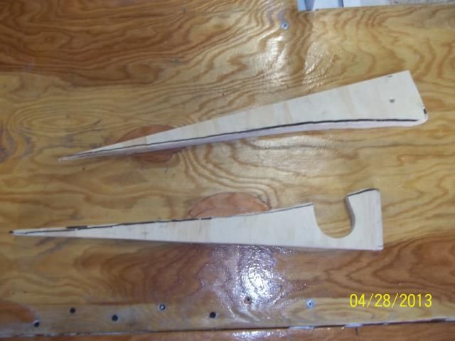

Gotta dam the end of the last piece for foam, took a pattern of the back transom and made these
which fit killer,

The other dam,

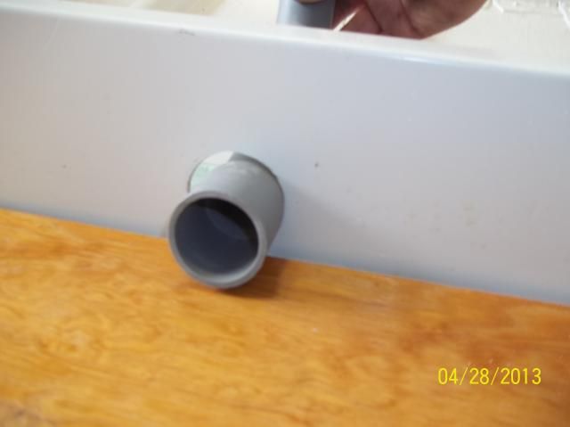

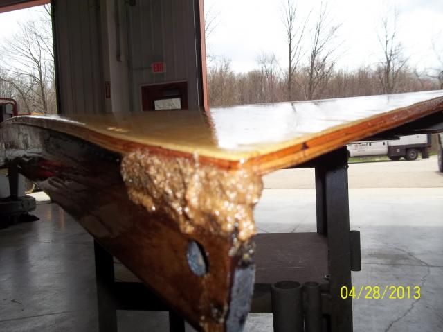

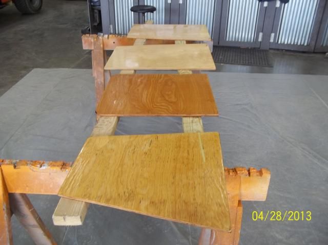

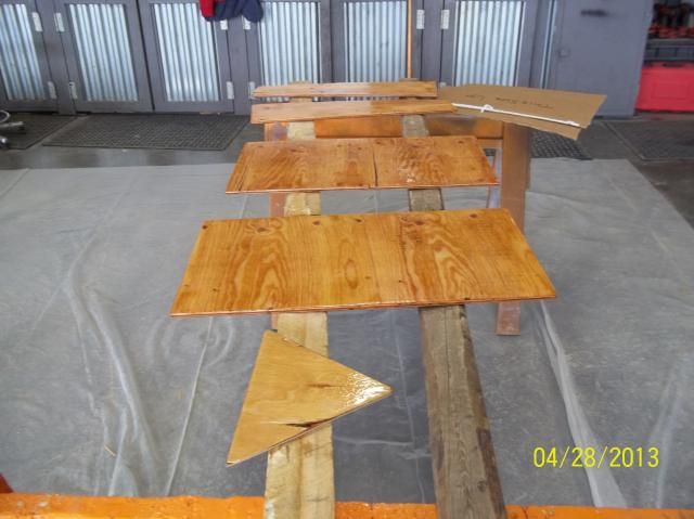

Gonna epoxy em up and screw em though the top and glue the gaps shut, should lock the floatation foam in nicely. Meanwhile Stephanie was sanding the bow piece and epoxying the rest of the interior pieces i had cut, mostly cuddy pieces.
2nd coat of epoxy on bow piece and another blob of PB, will sand it down one more time and reseal it up, should be done with it tomorrow night.

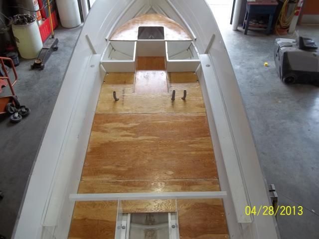

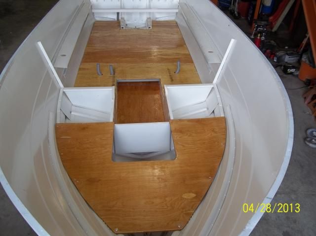

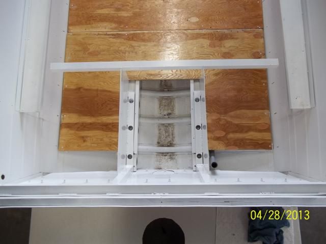

Birds eye view of today's deck job
Real happy with todays progress!!!!!!!!:joyous: Now I hope we get the high 70's temps Tuesday and Wednesday so we can get foam installed.
What ya all think, looking sweet or what? I think so!!!!

Took epoxy and dripped it into all the screw holes to seal them up.
It definitely ain't "or what". Sweetness all the way. :D
It your first pics I had a bad feeling. I'm so used to seeing foam sheets before a deck is laid down I went "oops" until I remembered the foam dams for pour-in. Whew! And you confirmed. Come on 70+ degrees for foaming! :)
Yep, seems a shame to go and drill holes in that nice deck to pour that rotten foam in there,But that is whats gonna happen

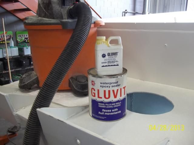

on another note there was one more thing that got done, vacuumed out my float pod and had some Gluvit left so I sealed all welds and bolts inside of the pod, my plan is to fill the pod with foam, at least to the point of the motor bolts.
Happy monday!!:grumpy:
:D
great work....moving along.... on your plan to fill the pod with foam.... i cant help but think of that as a step backwards....the pod is water tight, isnt it? adding foam would just add weight with no more flotation capacity...unless the pod took on a hole....
good luck and carry on....bob
Ya should be water tight, not real impressed with my inspection plate and I believe I will gain some structural support, stiffness from the foam for minimal weight gain, 2lb foam X 9cu ft = 18 pounds Right???
I wouldn't know, I don't have much knowledge on the weight of the pour in foam....maybe its a little insurance for only 18 lbs....I bought a used Mig welder yesterday! Millermatic 250 with a 30A spool gun. and a 50 foot extension cord. we welded up some cut off pieces from my big boat...welded easy...I was migging parts together in 5 minutes... way way way faster than TIG.....and since ill grind it out before painting...it doesn't have to be a beautiful as TIG....I think since I have the Mig machine now, Ill try and do a full pod under the swim deck on my outboard bracket. the hardest part will be figuring the shapes of all the sheets.bob
