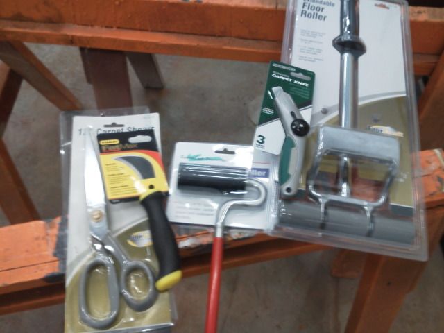

Vinyl flooring rollers,......
Find them at hardware stores,...Or maybe even the place you get the vinyl and glue from,...........

Laminate roller hit jigngrub w a pm, he may have a low cost provider, but I think HD &/or Lowes have them. Online too.
But TDF has ya covered too....

Vinyl tools,
Menards 76$

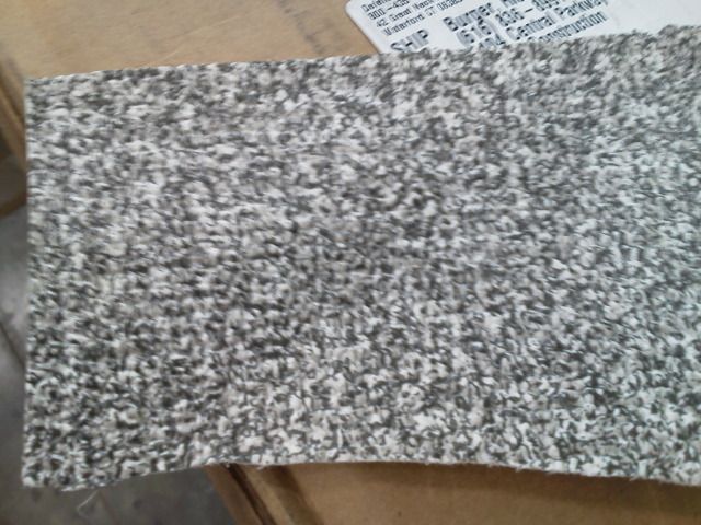

This week is not going as planned, seem to have gotten my yearly spring pollen dose of bronchitis, just struggled to do my job since Monday let alone any boat work, have been enjoying the tea though,;)
Had a nice ups care pack show up today!
AHH, got some cold feet on the color all of a sudden, will be nice and cool on the feet, real worried about keeping it clean though, Committed to it now!
May have to do a chunk of snap in where the bleeding happens and wash it post trip.
