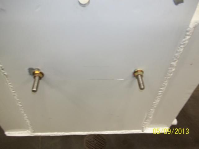

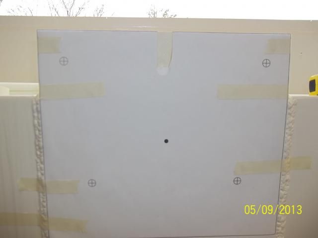

Got a full size cad pattern made up for the outboard mounting holes, if anyone needs it inthe future let me know, I will save the file and I think a Kinkos or office depot should be able to print it out.

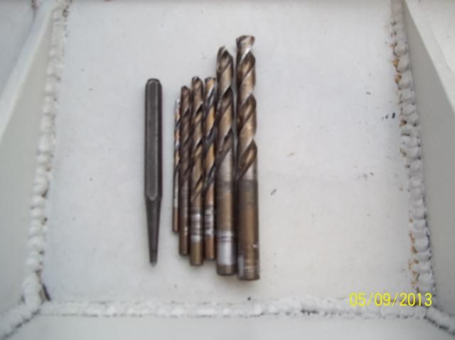

Center punch and steps in drill sizes gave me nice holes

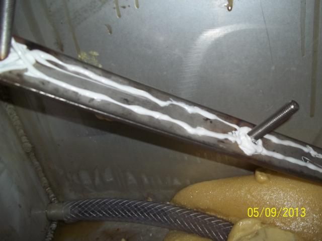

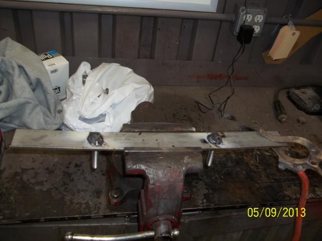

2"X1/4" stainless flat stock drilled and tapped, a couple stainless bolts for the bottom holes that are in the pod, lil weld makes for some nice captive bolts.
5200 and install
Obligatory wood epoxy shot for posterity
Lotta wood in this thing!
bob johnson
Feb 25, 2009
4,306
Re: Magnumdekes 1976 22' Starcraft Islander
are the nuts on those bolts just temporary?? trying to figure what your doing there?? is that strap set up with the welded bolts for the inside WHEN you go to mount your outboard?? you should do two sets of holes up top... so the motor will have another adjustment possibility... the lower mount holes on the outboards are usually SLOTS, so you don't need extra holes down there. I am mocking up my bracket in 1.5"sq pine, and have ordered my framing aluminum. bob
the nuts are there to hold it tight while the 5200 cures, bottom is slots and if anything on the top I would need to adjust down which is not happening without a jack plate!
