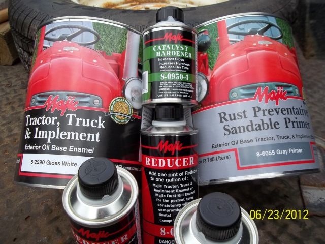

Went here on my way home
and got some goodies, I already have self etching primer, gonna give this stuff a try on the inside of the boat,most of it will be covered but I still want paint in there any ways
Hopefully I can get some SEM, and the oil based primer on and be ready for topcoat by the end of tomorrow.

Alright, Sunday morning and the smell of SEM is in the air!!!!!!!!!!
Viper grip is what I have used for years on many projects, here is the data sheet
View attachment viper grip.pdf
3 coats of Viper grip on at 11AM, 1/2 hour to an hour of dry time before I can spray the Majic sandable primer.
