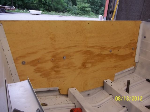

So I figured before finishing interior paint I should get the transom and bracket fitted. Lots of holes to drill in a perfectly hole free transom. It is also time to figure out the interior bracing, here we go!
Dropped my transom wood in and then used a forklift to hold up the bracket and drilled a couple holes and bolted it up to hold it
Hanging on its own
Went inside the hull with the transom skin from "ol 69"
Now I marked all the holes and removed the bracket to make it easy to drill them, I am using 3/8"x3" stainless bolts so I drilled the holes two drill bit sizes bigger to give me a little room for error. Time to move on to bracing the transom inside.
And one more pic of the fit with the bottom of the hull, cavitation plate on a 25" shaft motor should be even with the bottom of the bracket

So I want this to be strong as possible and transfer the forces to the hull via the "omc stringer" stringers Starcraft put in the hull. So I started with a piece of 2x2" 1/4" wall tube horizontally
I had predrilled holes along the line for the brace and then I marked the brace and used a 1/4 20 drill tap to thread them in
Next I added two vertical braces and drill tapped them 3/8 16, 3 holes a piece, bolts go through the bracket, transom and into the braces.
Now my plan is to lay tubes on top of the stringers and bolt through them, when it is all fitted I am going to weld it all together and make the braces one piece, also will be welded to the inner transom skin. Should be freaking rock solid!!!!
Got a little more planning to do before it is done, then tear it all apart and seal holes, paint the mating surfaces and caulk and reinstall. This for me is the crux of this project and I am happy to see it coming together!:)

Nice work on the bracket & fitment! Well done

MD - That's one tough looking set up. Old 69 is gonna live forever. Well parts of her anyway.

Wow! Double wow! Totally awesome!:D
