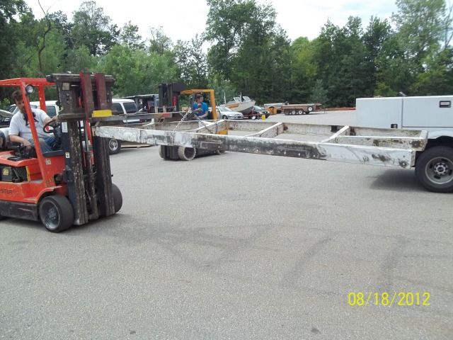

We broke the trailer completely apart

The "bolt on" axle brackets had been welded at some point in its life, I cut em off the frame, I figure i will have to change the center of gravity on the trailer. had to add some weld,
and smooth it back out

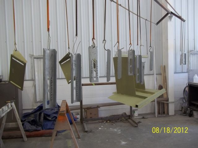

Meanwhile, I was doing some priming, roller panels, bolster brackets and rear seat structure
