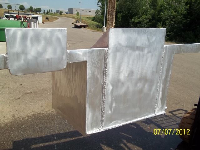

Well I made some more progress on the Out board bracket / swim platform.
Added support for the kicker bracket and the future swim ladder, two pieces of 2x2" tube
Had to notch the piece for the swim ladder backer, weld in the way
Added a drain tube and cut out for a deck plate
Interior of the pod
Plugged up
Deck plate and cut out
magnumdeke
Apr 13, 2010
626
Re: Magnumdekes 1976 22' Starcraft Islander
