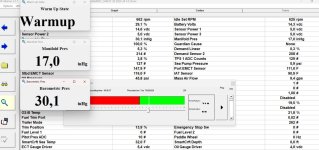

Only what found is vacuum pressure its 12in at idle and 0.5 at WOT. At 3000 7in and at 4000 3in. Correct at idle is 17-21. All sources on internet for 12in steady indicate problem with valves or timing chain. After season will take cover of and verify that.
The 12 inHg number you are worried about is from before the engine warm up state has completed. Unless you are troubleshooting a cold engine problem (you are not in this case) disregard all this info.
Once engine has completed warm up, you have about 17.6 inHg manifold pressure @ idle. Very normal number.
I'm guessing you might be getting confused about the manifold pressure numbers you see in Diacom. I'm not sure I can explain this properly (I'm not a very good teacher) but I will try.
If you hook up a mechanical vacuum gauge to a T that you install in the vacuum reference line to the fuel pressure regulator. Now KOEO and look at the gauge -- it will read zero, now look at Diacom -- it will read BARO and Manifold Pressure (MAP) as the same number, because the engine isn't running and there isn't any vacuum in the intake manifold. Now start the engine (KOER) and you will see BARO stay the same but MAP will read a lower number, now look at the gauge -- it will read the amount of vacuum in the manifold. If you want to check the accuracy of the gauge, take BARO and subtract MAP and you should get the gauge reading.
i.e. BARO 30 minus MAP 12 equals 18 inHg. Pretty high vacuum.
Does that make sense?
So a MAP reading of 0.5 @ WOT means there is almost no vacuum in the manifold.
So I think your barking up the wrong tree worrying about MAP numbers.

What do you think about this vaccum pressure at idle. 12-13"Hg its not normal. Checked manifold for leaks but found nothing.
When you checked gear ratio did you disassemble and count teeth or count input shaft revolutions compared to prop shaft revolutions? In a situation like you have, I wouldn't trust the sticker on the side of the drive!
Also suggest you recheck fuel pressure how the manual recommends and report the all numbers to us.
I know what diacom shows in regards to MAP explained it to someone just like you did few days ago under post #18.
During Diacom test vacuum gauge was connected to manifold and never showed more than 12.5" on idle. BTW see attached. It's below 13"

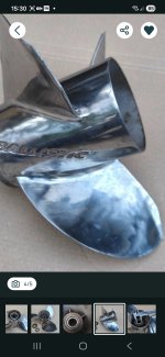

Props - turning point 14.25x21 and I thought that boat was sluggish because of that and replaced with SS 14.5x19.
As long i won't see correct vacuum pressure I will be barking under that tree 😉

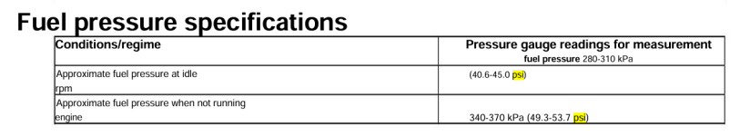

@muc Checked manual and 45psi is correct fuel pressure for that engine.
That chart is at idle. But you posted.
"Fuel pressure steady at 45psi - checked under load while on plane."
Under load should be about 5 psi higher. If you look about 30 pages deeper into the manual, you will find 50-54 psi with reference line removed. Removing the reference line will bring the reference side of the fuel pressure regulator to BARO, so basically the same as running under load.
