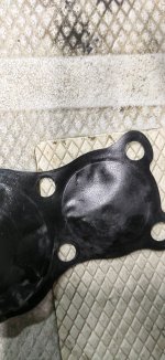

When you rebuilt the motor did you open all the covers? Like exhaust? Did you make sure the cover is not warped? My engine, a 120 was running like **** and dying at idle, had to run it at higher idle to stay in gear and not die. I was getting water in the cylinder chambers. But I was getting 4200RPM. I have twin 120s so it is easier if I run them together, if I ran just the one engine I could only get up to 10mph and it was bogging all the way.
This was after rebuild. The cover was way off at 0.020in in warping. I used a special stone and brought it back to straight at 0.002. I am wating for parts to get it back i the water.
You said you had leak from the head gasket, that's not good maybe the head is warped. Could be ok but these are small things that make a difference.
The carbs might also still be dirty. Recirculation also could hacve some dirt.
You did rebuild them and check the floats for right functionality. The screen at the fuel pump you didn't mention it was cleaned. Hose clamped etc. Most of these don't matter in the big picture but 1200RPM and that's it is not good. Mine is at 4400 and I also bought 2 new props from 19 down to 15 to get the 5200 or so hopefully. The timing is at wot with engine off cranking timing 28BTDC. Measure the stator and trigger as per CDI electronics guides. It is weird that you don't get more RPM. I mean can't you test at home in a small plastic tank and see if you get more RPM when you adjust the idle screw in. It should give you more than 1200 at idle.

I think you can remove the gear engaging cable and try to put it in your tank at idle and accelerate without going in gear briefly to see if it goes up in RPM. I had the same issue in the parking hose it ran great in the lake it would die in gear unless I set RPM screw at max. Went there3 or 4 times. It is pretty annoying.
And then I founf the water in number 4 on the piston.Ipened up exhaust and there was milky residue on 3 and 4. I had to resurface the exhUst cover, I got new gaskets and a separation plate, and I got another head just in case. I hope that ot will seal the area andnothave any leaks.
But I was getting 4200 RPM in gear but only withy twin engine on, without it was a mess. Since you only have one engine it is different. But remove the shif cable and keave the throttle and see if it accelerates passed 1600 briefly and clean. You shouldn't cause any harm with short bursts. I am.surprisedyou don't have a bipassbutton at the remote to pushin andonly use the remote to warm it up without engaging. My friend's 96 force has that. I don't because mine is a twin engine
