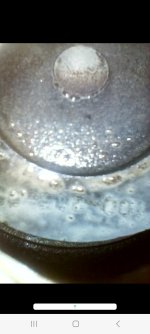

I don't know if that is any better then 1200 in gear on the lake. Kind of the same. You shouldstick an endoscope camera after running it and look at tye pistons to see if you have any water. Here is a picture of mine. It's the number 4. The motor ran by itself was bogging down severely. Sounding like it was coughing up flam hahaha.
That altitude deal I am not sure about. Was your boat equipped for high altitude or not? I took a 97 Bayliner I/O carbureted to Lake Tahoe 6200 feet and I was ok with stock carb adjustment. So that should not prevent you from getting higher RPMs

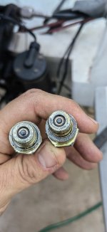

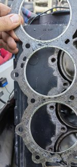

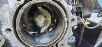

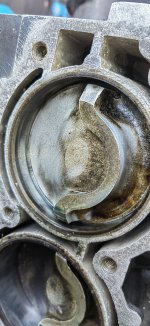

So I finally got the pump diaphragm, valves and some gaskets I thouvht were bad and rebuilt the pump, it fired up very quickly sounds good on muffs 1200 RPMs no issues would not Rev up more on muffs. I didnt get the boroscope so I rather took off the head again to have a look after warming up the motor, I did noticed some drops of water on cylinder 2 and 3, but they are perfect clean drops so I dont think they come from a leak, I think they just got there when taking the head off and some water comming from the block, there is no milky stuff I can see the fuel there is very blue so I think is no contaminated, what do you think?
Here is a picture of piston 4 on mine through a scope. At tyecenter you will see the clear water bubbles that look pretty clean. The milky stuffwasin the exhaust area on mine.

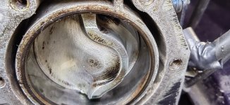

Got back to the lake again, changing the fuel pump diaphragm didn't did any difference, this time I went with my father, he knows some mechanics he suggested to open the carb needle a little bit I didn't tried that before because it idled good and I thought that needle only worked in idle, anyways they were close to 1 turn and we got them to 1 1/4 turn it immediately felt better I was able to manage 2000 rpms before stalling, If I kept trying to accelerate the motor stalled, I opened them another 1/8 of turn and I was able to accelerate a bit more didn't stalled but still didn't felt very good, I stopped there I went also with my 3.5 year old son and wanted to have him on the boat and try to fish something, so we did some trolling and he finally saw his first bass! I will keep now tweaking the carbs for next time, maybe do a full clean up and then adjustments.

The air screw is for the air fuel mix at idle or close to idle.
Past 2000 the main jet takes over.
Try cleaning the carb and make sure all passages are open.
While the carbs are off: look in at the reeds and make sure they are closed or close to being closed. A small gap is acceptable.
