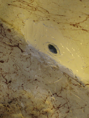

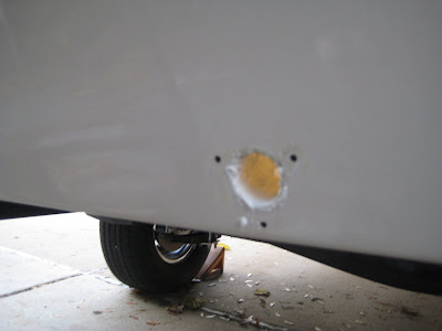

Last Saturday I decided to install my Smart Tabs. I was tinkering around in the bilge and noticed some debris by the plug exit and decided to take out the plug and look from outside. This is what I found.

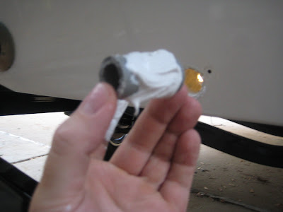

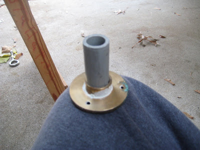

The inside of the hole was not finished and was wet wood. I could scrape out wet wood particles with screwdriver. I about vomited! I called the dealer, took pics, sent them to the dealer. He wanted me to bring the boat in so they could see/fix the issues. But due to some crappy wiring they did, rigging the boat i decided to dry out the hole with heat gun for 4 hours, and repair myself. They assured me they would stand behind me and the boat is under warranty.. Don't worry and go have fun! So I proceeded... After drying with heat gun, the wood seemed very solid, and I could not stick the screwdriver or remove more wood like it was rotted. I proceeded to seal wood with 3M 4200, cut a piece of PVC, inserted into drain plug hole, and sealed it from both ends so water from bilge would not touch the wood, and drain out the plug hole properly.

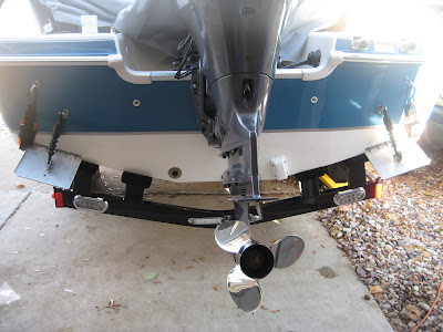

I decided to install the port side Smart Tab with no issues.
Upon drilling the holes on the starboard side to mount the hinge, on the 4th hole toward port side, water started running out when I removed the drill bit!!!!!!!!!!!!! OMG!!!!!!!!!!!!! I took pictures, my friend is sitting there with me in disbelief....
