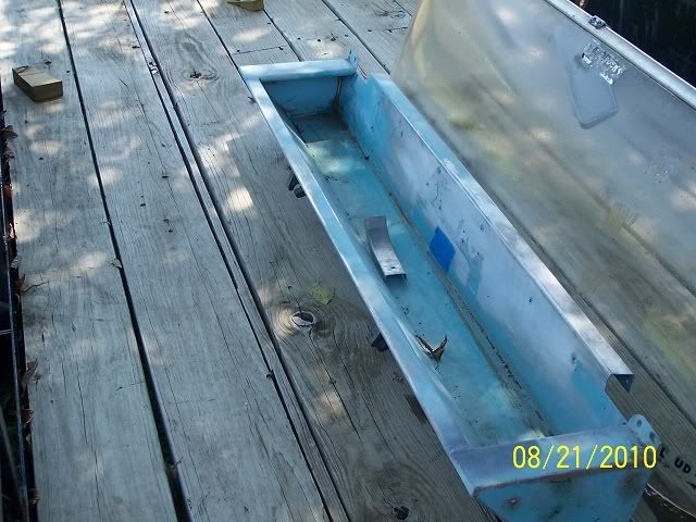

This is the splashwell on my "Flamingo" It's only 6" deep and 6" wide tapering down to 4". I have a high Transom so I'm guessing it will be sufficient. You could fab one of these very easily. Would not HIDE anything but would prevent some of the backwash if you have some.
Hey Woody .... I am trying to picture how that mounted .... have any pics of it on the boat?

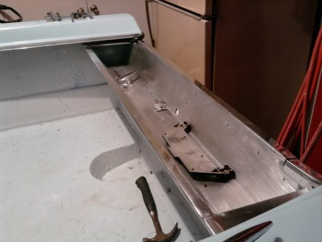

Here's the pic of it temporarily mounted.
AS you can see it has a lip that hooks over the transom and serves as the Transom cap along with some additional side pieces. They screw into the transom with small screws to hold it all in place as well as the drain tube holding it secure. Everything was 3M 5200 coated when I put it back on.

Thats nice and would be easy to build ..... I didn't realize that your transom was straight across. Mine is lower in the middle.
