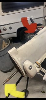

Hi all,
1967 33hp evinrude. With plugs out, I engaged the starter and find that no water comes out the discharge port (red arrow). Impeller is installed correctly, the intake to impeller is clear, as is the tube leading from impeller to supply water to the head (yellow arrow).
I blew into the tube (yellow) and very little is any air came out the port (red). I figured the amount of air coming out of the port would be the same as The amount I blew into the tube. No? I noticed about a 1/8” hole in the tube adjacent to the screw of the shift lever connection, but it’s hardly enough to bypass all the air I blow into the tube to allow zero air out the port. What may be the issue?

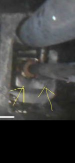

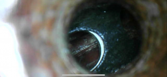

Got it running but it started to get hot. Very little water came out the upper port (red arrow previous photo). Laser temperature indicated 275° on upper block. Took lower unit off, connected hose to water tube and water came out upper port and what appears to be the area around the shift rod at the top where the tube goes into the block. Yellow arrows show water spraying from around that area. Normal? Gasket/seal bad/worn/gone? ?
First photo is shift rod, and water tube going
Into block
Second is “leak”
Last is inside water tube going into block
again, impeller is new and installed correctly and spins with drive shaft (key pin in place).
Blockage doesn’t seem to be an issue. Hopefully some input will clear this mystery.

Not worried about color. I previously posted photos showing what looks like water spraying around shift rod at top where water tube goes into the block. Is that normal? Doesn’t look like it’s coming from where the tube slips into the block, but just above it maybe? Is there a rubber sleeve that deteriorated allowing water to squirt like in The photo? Isn’t all the water supposed to go into the block to circulate (besides the 1/8” hole midway between pump and block-cooling jet I’m told)?
F_R
Jul 7, 2006
28,226
The flared upper end of the water tube is simply a tight fit into the cavity in the housing. No rubber seal or anything. It is not unreasonable to expect some leakage, but certainly not enough to have a negative effect on the cooling. Unless there is a big chunk busted out of the castings, remotely possible, but extremely unlikely. And all those passages are big enough to stick you pinky finger into---not likely to plug up.

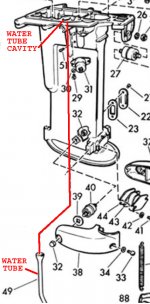

If you truly think there is an obstruction or bypass, it's time to pull the powerhead and look for it. Personally, I think you are barking up the wrong tree.

Photos in thread #13 shows the opening from tube to block, so no blockage there. Other 2 photos show shift rod and water tube just below the block. The blurry one shows water spraying around/above shift rod attachment (water sprayed on lens). Seems a lot of water not going into the block since it’s squirting above shift rod. I’m trying to exhaust all possible replies and inputs to avoid having to remove the exhaust section from the lower cover/block.
