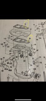

Is it possible to drop the exhaust housing from the steering bracket and power head without taking power head off?39DA054D-BE3F-4CB0-A3EB-C74988522ED8.jpeg Maybe the plate gasket(s) are broken (#96) allowing water to squirt out over/by the shift rod..
kdiddle
Mar 22, 2018
147
I'm not sure what correlation the exhaust/powerhead has with the steering bracket. But in my experience, you can't get the exhaust cover off without removing the powerhead entirely. As I recall, there is a single bolt that you can't get to due to the lower cowl being in the way (but someone feel free to correct me if I'm wrong)
39,788
No short cuts.----It is a simple job ( in my opinion ) to remove the powerhead in order to inspect cooling system.

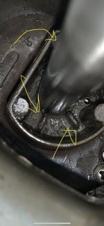

Question. Is the o-ring (#57) supposed to go above impeller housing (3)? There are 3 vertical fingers that prevent the o-ring from seating onto the flat upper surface, of the upper impeller housing. If it was flat, what purpose will it serve just sitting loosely on the top of the housing does nothing. My buddy and I put it between impeller and upper housing (3) and I believe that is what caused my issue of low water flow since there is now a gap the thickness of the o-ring (just under 1/8”) that will allow water to just flow over impeller blades instead of pumping, giving almost no flow (which is what I experienced). Before I put it back together, where EXACTLY does this o-ring go? #57 is described as “O-ring, driveshaft.” Thank you to all454DC14A-CF79-44C8-A95F-F5C5C0F02E5E.jpeg
39,788
I think that o-ring fits in the groove of the driveshaft.---Just below the upper spline.----It seals the crankshaft spline and driveshaft spline.----Keeps the crankshaft spline from rusting out !!----Very important part.----And that o-riing has nothing to do with the operation of the water pump !

Ok. That’s possible, but I didn’t remove an old one from there, not that it didn’t bust/fall off years ago. I lifted the lower impeller plate (5) and there is a groove in the cast, maybe the o-ring goes between cast and #5?
Below: Top of impeller housing. Arrows point to “vertical fingers62BDFFA1-AEFF-43A1-809D-C6B2272DB2AB.jpeg” that prevent o-ring from siting flush.
39,788
Sorry if you mis-understand !----The o-ring fits in the groove at the top of the driveshaft.
