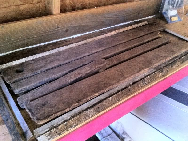

I finally got to take the measurements on the ski locker cover.
Wood area: 38 3/4 in X 12 in
Metal "support": 39 1/2 in X 12 1/2 in
It looks like the part of the metal pieces that actually supported the wood laid on top of each other with the long piece (39 1/2) laying on top of the short piece (12 1/2 in). Unfortunately all of this was disassembled when I bought my boat so I'm not 100% sure that this information is correct, but its the best that I can figure out.
Here is a picture of what mine looks like roughly pieced together:
There should be one more hole catty-corner (or diagonally) from the one in the picture.
And here are some websites I've used as picture references.
