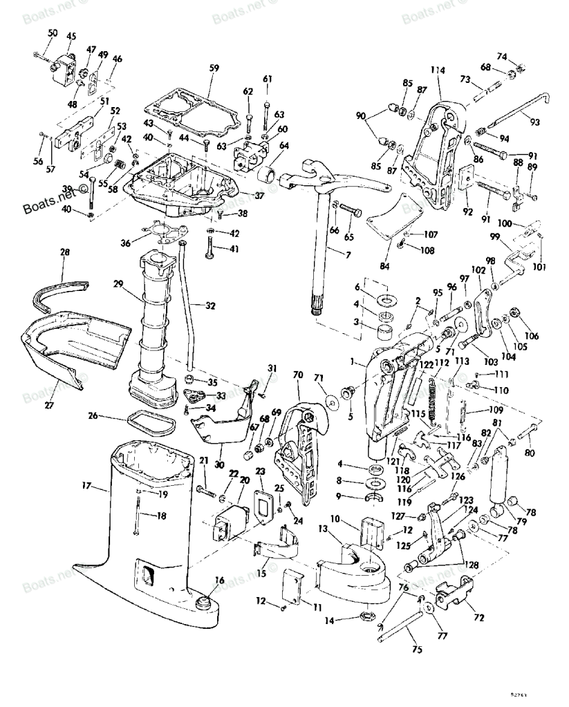

With or without the complete trim ram system, the swivel bracket should come down and rest on the thrust rod assembly. Hard to tell from the pictures, but it may be missing. It's a long pin that goes through both transom brackets. there are 5 or 6 holes in each, and you can select how much static trim you want the engine to have. 385512 is the part number of the original OMC part number. Most factory diagrams show that pin on the 1976 exhaust housing exploded parts diagram: epc.brp.com It's item #93. At this point the lift bracket serves no purpose and can be removed-unless you want to rebuild/refurbish the whole trim system.

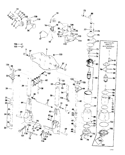

Full OEM systems and cheap are not words normally used in the same sentence :D.....the system would look like this plus wiring harness, switch etc......
This image is taken from a '75 model.....no 135hp's were produced in '76 that i can see.

I'm still trying to figure out what the deal is with the bar in between the the 2 manual assist cylinders.
You might be referring to #123.....listed as "trail lock arm assembly"......the rams #79 are actually listed as "shock absorbers".....although there is only one pictured there are two listed for that motor.
