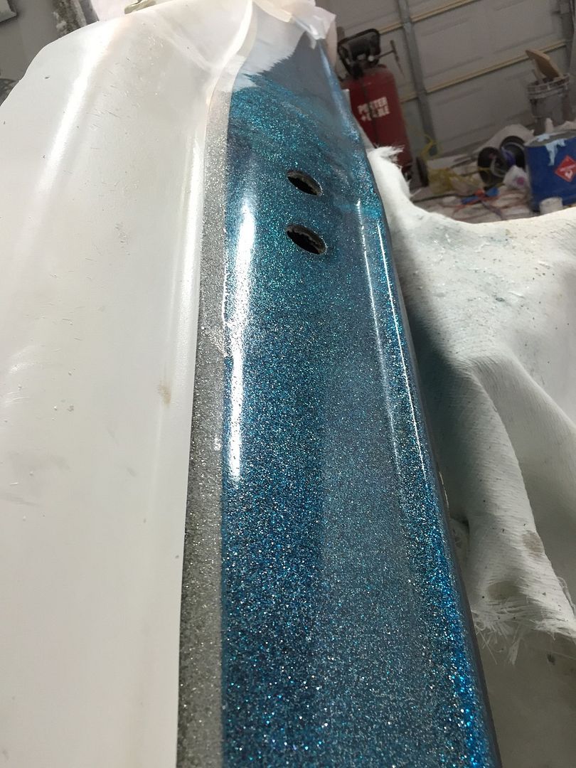

I did some test wet sanding on the clear and it appears that I have a decent layer built up and it sands down pretty well. The clear started to get kinda gummy so I stopped since It wasn't my final layer anyway. I added wax to my clear and sprayed what I hope will be my last coat of clear!! I'll work on wet sanding it all down while I wait on getting my replacement quart of "Off White" :)
Somehow I managed to misplace the "long pointy thingamajig" that goes into the spray gun to regulate the flow so I moved my 2.3mm tip over to my harbor freight purple $9.99 gun and sprayed. Gotta say, it worked much better than I expected and I think it was the best volume that I've been able to get out of the sprayer so far.
