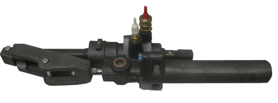

Hi guys,
ok i need to clear some things up...
got the locking nut off, but cable won't come out and when i turn wheel i can see the cable trying to move and loose nut moving back and forth, which ofcourse means the cable is, but it's the rod end stuck in the tube.
i've read Don S saying about applying heat to remove, do i apply heat to the black tube or to the steering rod?
is the rod, right to the end with the hole in it all supposed to come out, ie is it all part of the cable?
am attaching a pic, do i heat red or gray :)

Re: Removing steering cable
If you remove the nut end and the cable part moves then yes, the rod part is corroded in the tube . Apply heat(gently) to the red colored part and apply a penetrating oil to the end of the red tube. Once removed the tube must be cleaned of corrosion by a long wire brush, a 12Ga. shotgun brass brush,plumbers brush,etc.
When servicing steering cables yearly, a handful of grease is applied to the rod while someome moves the cable in and out a few times.
