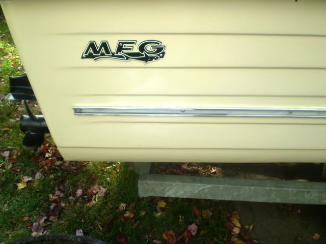

Well, the emblems are done and on my boat! :D:D Here are some pics....
Overall I'm very happy with the results. Hope you like 'em too!

Your boat is simply amazing. Awesome Awesome work. Your attention to detail leaves me speechless. I can't wait to see it when it's a 100% complete. How much more work do you have left? Again, great job.

Thanks for your kind words..... Once I made the decidison to fix her up, I had to decide how far to go. I decided to return my boat to original condition. As close as possible of course. My thinking is,..... if I take care of the details, the rest would come together.
My current progress is not going as well as I had hoped. Lost most of the summer do to a heavy work load. Now I'm racing against time and weather to get things done,
The fiberglass work is 99% complete. I have some touch up at the bow. That's gonna wait till spring. The interior needs to get done. Along with the wiring and rigging. I still have to varnish the ski racks I made and a whole laundry list of small things.
I'll keep posting my progress as I go. Hopefully, a nice warm spell will come along before the snow flies. :rolleyes:
