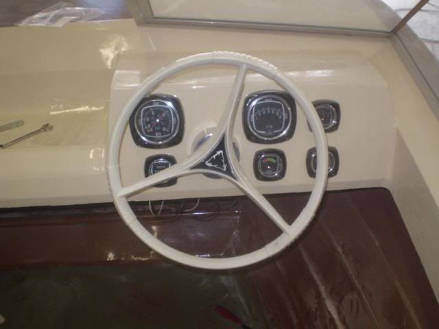

A pic of the dash.
Making a template and two mock-ups proved very helpful with the final install.
I'm real happy with the new steering bracket. The chrome Bezel looks super! It was worth the extra effort.
I still need to mount the Power tilt/trim switch on the upper right and a horn and Nav light switch below it.

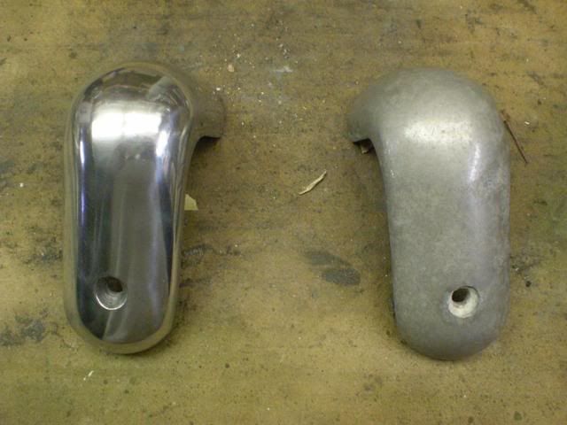

EdC- Maybe I missed it but what did you use to polish your aluminum trim with? It looks GREAT in the photos.
matt9923:"but what does tilt mean?" The trailer coupler and tongue from the "Y" section of the trailer has a pivot point and a pin or latch to secure it. You release the pin or latch and it hinges up there so the rear of the trailer drops for easier loading, but I never found it easier. The Niagara is light wieght, but not that light! I'd just as soon winch it on than hold my mouth just right while using the force, Luke just to get my boat on the trailer.
*EdC*
Oct 31, 2007
661
Re: Restoring my MFG
"EdC- Maybe I missed it but what did you use to polish your aluminum trim with? It looks GREAT in the photos."
Hey Mark,
I used a product known the world over. It's called "Elbow grease" :rolleyes: lol.... just kiddin'. The Aluminum transom trim was badly beat up. If it wasn't irreplaceable I would have chucked it and got a new one! The first thing I did, was to straighten it out using various hammers and custom made dollies, mounted in my bench vice. Once I had the shape looking respectable, I started in with 150 grit sandpaper in a detail sander. Then moved to 400 grit. Both used dry. After the nicks and gouges were removed, I put it on a polishing wheel mounted in my bench grinder. I used a "stick" compound for aluminum. (got it at Sears). This one piece of trim took me eight hours to get it looking good. :eek: I finished it off with Mothers Aluminum polish. I also did the lower rub rails the same way. Spent a week of evenings on each.....Thought I'd never finish.......:D

I am impressed. I only went to 600 wet/dry on my aluminum parts!
HeHe... The devil is in the details Buddy :D Ya know a man gotta do, what a man gotta do! :rolleyes:
And...... I'm seriously thinking about doing the upper rail. If I'm really feeling self-destructive, I may even do the windshield frames!!!........naa...maybe......
