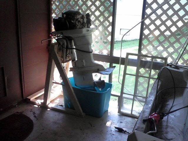

could do something like this (Raised to submerge the intake) filled with water
or use a 55 gallon drum and lower motor into it

With no offense intended to the person who posted it...... this post is misleading because I can assure you that at least that particular motor will not be able to be lowered enough into that particular container to effectively pump water. The pump is located on top of the lower unit and needs to be completely submerged in order to work properly. Filling up a container enough to cover the inlets is not sufficient. I found this out the hard way.
