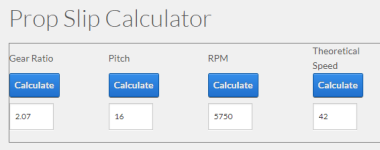

That said, I have talked to another owner of the same boat and model that I have and they are running a 2009 115hp Mercury, and said they reached 42mph. So I believe the hull speed comment is incorrect. 42mph is closer to the estimate Mark gave from the calculator website.

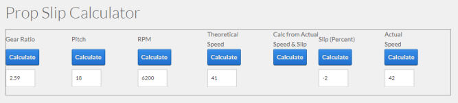

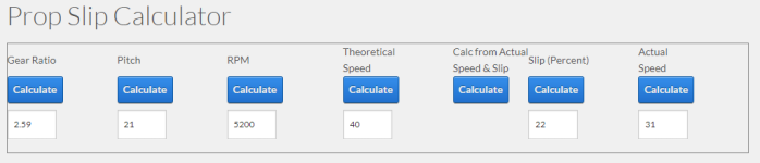

From the suzuki website, the gear ratio on my outboard is 2.59:1.
Putting in actual figures from my experience (21P, 31mph, 5200rpm) it gives me a prop slip of 22%.
Putting in the figures given to me from the dealer's sea trial (19P, 34mph), it gives an rpm of 4894, about 3/4 throttle.
Putting 18P and max rpm (6200) gives a speed of 41, close the anecdotal 42.
Putting info from the mercury owner, I get 16P.

With the 2.59 gear ratio on the Suzuki engine, I can see where the higher pitched prop is in order.....2.59/2 x 17 = 22 pitch right in line with the dealer's prop submittal of 21. One can only speculate that a new engine is performing up to it's design ratings so blame for poor performance lies elsewhere....speculation again.
Gut feel: With what you said about the new engine and gear ratio and the performance results so far, you have an underlying problem somewhere.......
