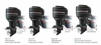

I'm confused why I would want to lower the outboard, looking at this graphic, it seems counterintuitive to what I want (more speed?)
Raising the motor can give more speed as long as it's not raised too far. Others are wondering if yours is raised too far and loosing bite as it nears the top end.
