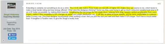

I was reading an old post about extending a boat, no don't worry I am not interested in doing that in the slightest... but I found an interesting passage that I think applies. Even tho the boat in the original post is a skagit, my make is pretty similar in form. I did the math and my length/beam ratio (226" length / 90.5" beam) is 2.497. Which I believe means it is even more beamy than the example boat).
I don't think it is possible to get the bow of this boat totally out of the water, while also being level (which is what you want, for speed correct)? I also attached a pic here of the boat showing how low the bow is compared to the transom when the boat is sitting on level ground.
Also, when I'm on plane at full speed and I look off the back of the boat (lay on the splashwell and look down) I see that the transom is maybe 6" deep in the water or more. You can see the wall of water go by as the boat is cutting through. So, that would make me think I want the 4 blade prop, to give lift? Does it lift the boat in a level fashion or just lift the stern, meaning bow goes down? In which case the benefits would cancel each other out?
