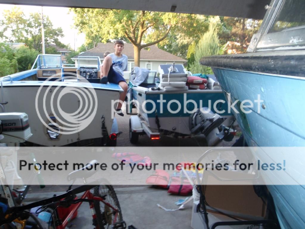

got the penta yesterday. picture shows two boats next to each other about to have motors and all sorts of stuff swapped. as my starcraft has nothing at all, and donor boat has everything it could wish for in for stripping.
chieftan 22 1969 of course:)
with Super Sport in background. you can see bolt pattern i am hoping to match.

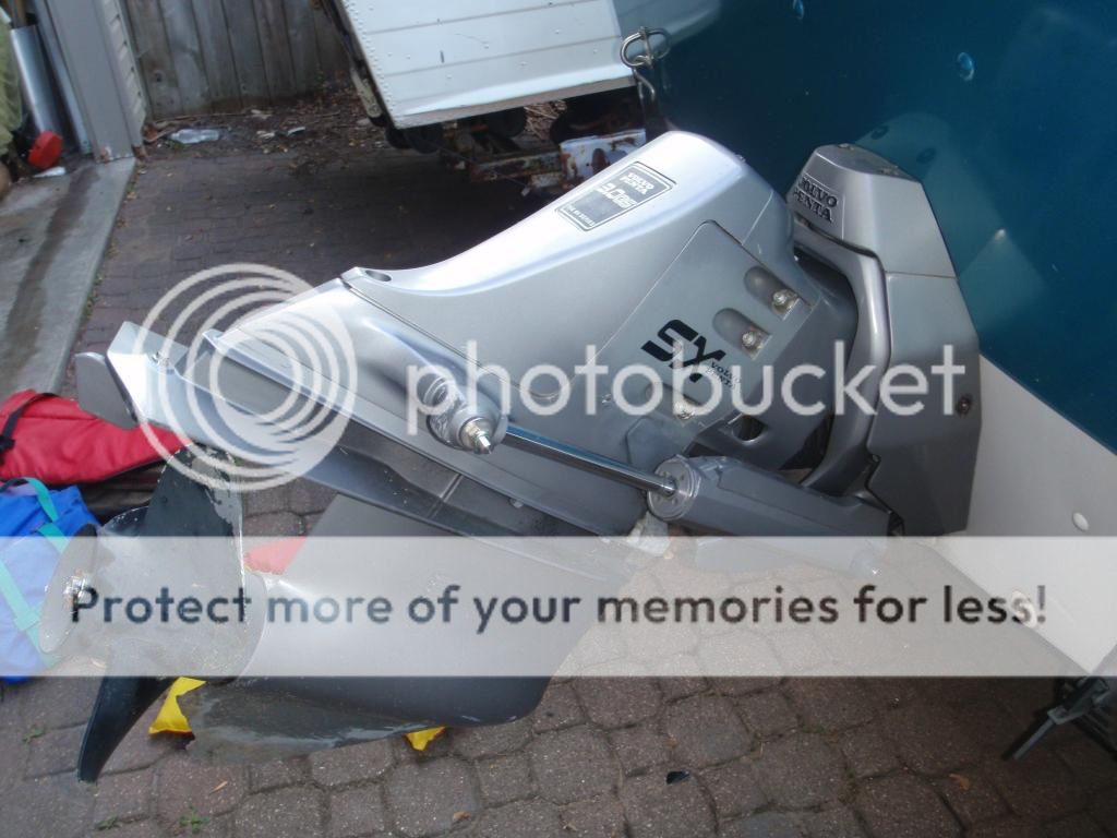

look at the donor motor.new prop that kissed bottom . only a year old.
easiest fix to get the boat out. im thinking temporary solution, till i get an outboard bracket and extra long shaft

im thinking i will need to upgrade to the heat exchanger add on used in marine applications.

Looks pretty clean! I also have a 22' Super Sport.....
Nice donor Stern drive. My advice is to convert the 3.0L to closed cooling ( heat exchanger ), install it and forget the outboard/ bracket. That will make a good modern powerplant for the boat.

Hey PB --- really nice looking donor parts --- 22 is looking cleaner. Should be interesting as to what you find below the floor!
Since you now have a motor and drive... might be your best bet to just stick with that route. Course it's your call... but it'll work as intended.
Nice progress!
ive got the 140 4stroke but it needs conversion to extra long. i think that is going to be the ulitmate goal.
we run the lake all the way to the last day. last year pulled off the lake and it was skim ice frozen by the time i got the boat ready for the road. im not looking forward to doing winterizing coolant flush on every cold weather trip.
