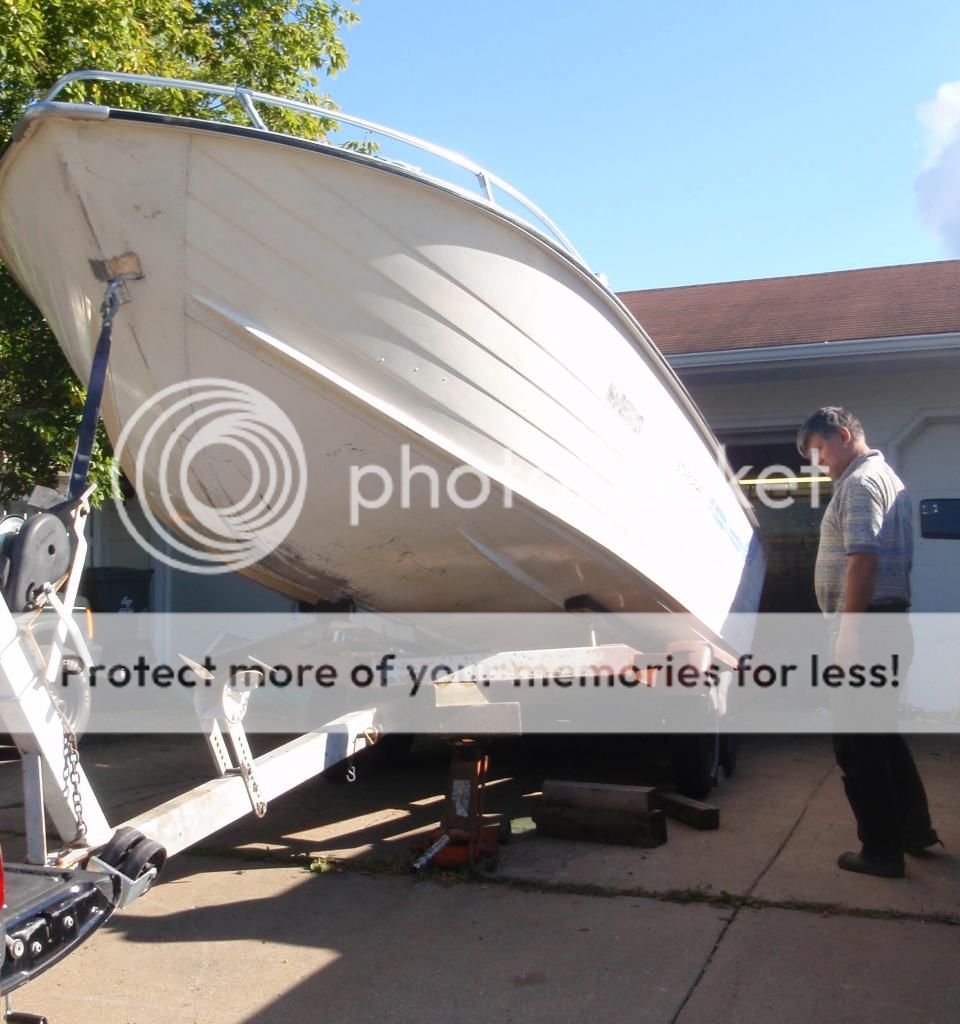

share the updates. motor is swapped from donor boat to starcraft. we had trouble reaching over the high hull of the starcraft. ended up tillting trailer up on 6x6 beams, and pinned the tilt wide open with 2x4 jamed into it. lucky it wasn't welded.(tilt mechanism on the tilt trailer). picture comes close to the excitement in the neighborhood for this project. tip of boat is up higher than the roof!

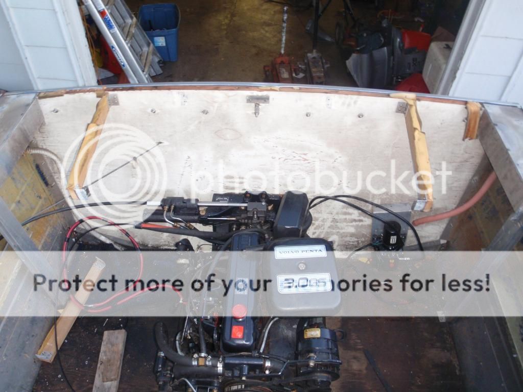

here is the motor going in.

power steering mounted first.

fully mounted inside look.

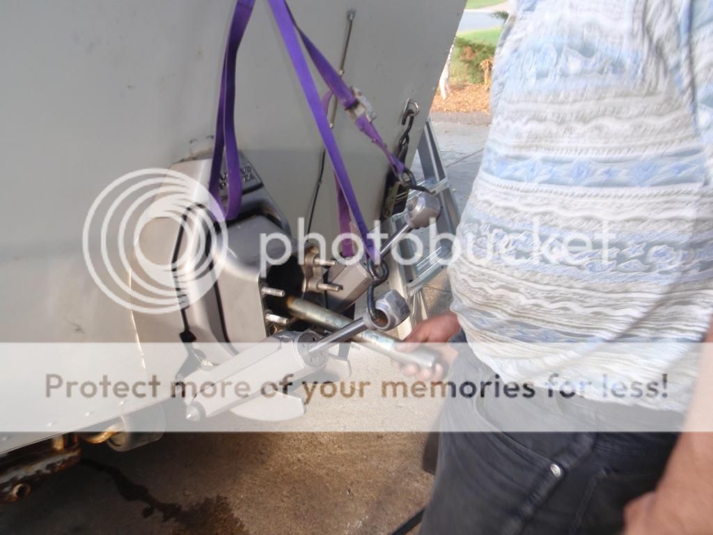

passes nearly perfect alignment check on first attempt!
