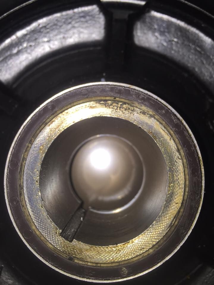

I have disconnected ALL of the wires coming into the powerpack, except for the orange and orange/black from the power coil, and the timer base. Thats IT!!!!!
I suspect bad AC voltage coming in. The new stator tests a little low for resistance (93-103 is spec, and I get 89). ALSO, they painted over everything with the reman powerhead. I had to sand down the contact points for the ignition coils and where the starter grounds to the block. Guess what I didn't sand down? The places where the stator sets on the motor (as seen below). Although, I would think the 4 screws that hold the stator down would be a good enough ground.

Nice photo, looks good to me. ​ Stator does not need ground, just a clean block contact for heat transfer.
Have you checked the output voltage and ohms of the power coil (2 orange wires) and output voltage and ohms of timer?
Sorry, not really ground but I meant a solid contact with the block.
