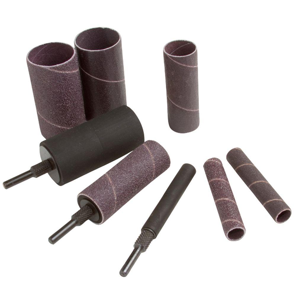

how can I "clean up" the tunnel to see fresher wood and also have a better surface to coat with whatever sealant I choose? Can I dremel it or hole saw it slightly larger or something to remove a thin layer of the dirty, ridgy wood?
kcassells
Oct 16, 2012
8,743
C'mon man get into it! This should do it. Harbor freight or local home deblow.
