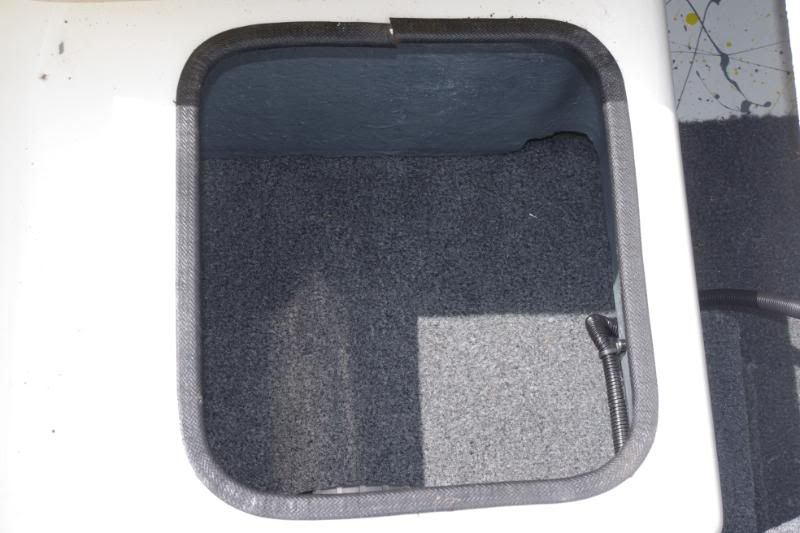

completed the carpet and rails on one side. Waiting to complete the other side until all wiring is done.
Radio is in and all working.
